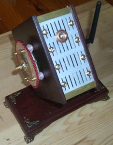

Step 2: The Case
I decided to build a case out of wood and slotted aluminium metal plate.
Parts:
2 pieces of wood 12,5x12,5 cm 6mm thick
2 pieses of wood 13,3x13,5 cm 6mm thick
4 pieces of aluminium metal plate (see pictures) 12,5cm x 6 cm
4 brass profiles (see photo)
1 piece of wood 20cmx10cm 21mm thick for the stand
some brass screws and washers
I drilled 4 holes in the smaller piece of wood for the srcews to mount the mainboard. The harddisk is located underneed the board.
I glued the second pair of wood pieces together to build the top of the case.
In both I drilled a big hole for the airflow and 4 holes for the baring, we will see later.
I used wax stain in mahogany colour for all wooden parts.

Step 4: The Bearings
The bearings are made of two thin slices of wood with brass applications.
I covered the bigger peace by a red cord with brass endings.
The brass nut covers the power switch.
On the opposite side of the case there is the WIFI antenna and the angle bracket for mounting the computer on the stand.
The stands have been bought in a clockworkers shop called SELVA.
