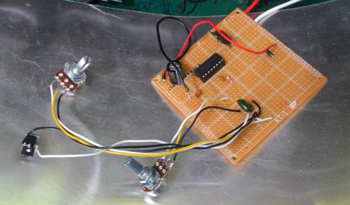

Step 7: Build the Circuit
After you have tested to make sure everything is working, start building the prototype onto the veroboard.
If you notice in the pictures, I use an 16 pin socket for the TL494, it is really good idea to use sockets for the IC' s because you won't risk heat damage from soldering, and if the IC fails, you can easily replace it instead of desoldering it and solder another one in..
I also added an LED indicator, that is a good idea to add that on too, so you know whether the circuit is on or off. The LED indicator is connected to the TL494's power supply line.
After you had done soldering, make sure you made nice shiny solder joints and they are no solder bridges. If you think it is all good enough, add some dab of hot glue onto the loose components and wires for strain relief.

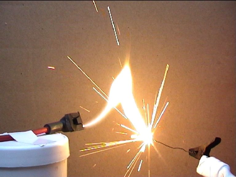

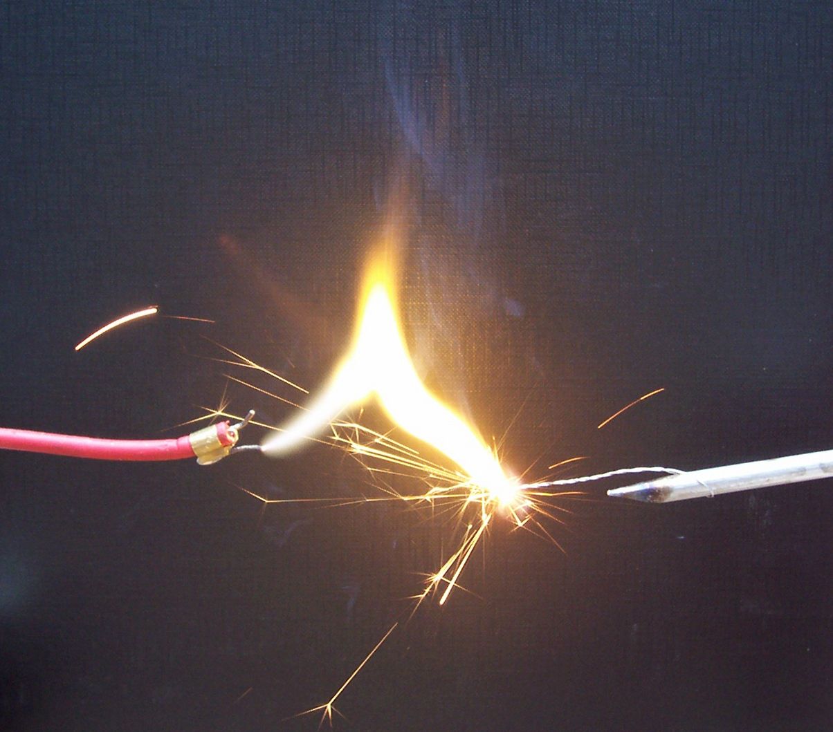

Step 11: Interesting Discharges...
While I was testing (well, playing) my plasma speaker, the 12v battery is going flat and the arcs are becoming unimpressively short. So I replaced the battery with my lab PSU I modified from an ATX PSU and put an 22,000uF capacitor in parallel with its 12v output and ground.
The 22,000uF capacitor is used to adsorb any high voltage spikes that may appear on the line.
When I connect the PSU's power to the plasma speaker and turned it on...
The arc are very different, instead of a sting of purple light, the arc flaps furiously and it makes very interesting light display. But this is not suitable for a plasma speaker, because the arcs flaps so much it just simply drowned out the music...
Here is a video of the arcs.
