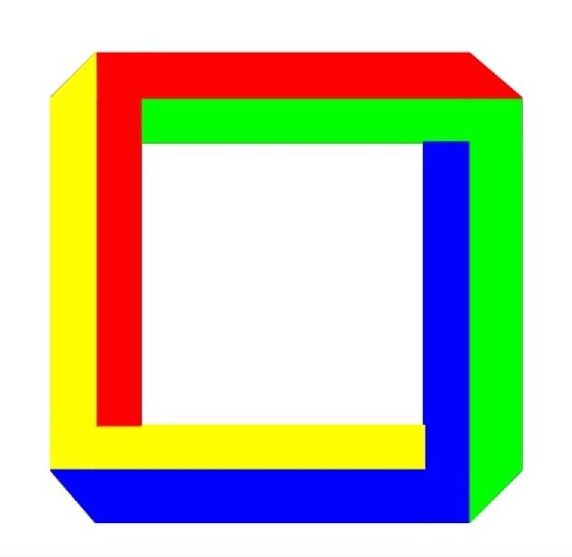

Step 2: Glue Up the Panels
I used a biscuit joiner and #10 biscuits.
