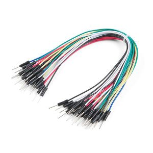

  9. Jumper wires

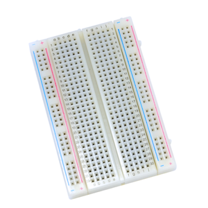

  10. Breadboard

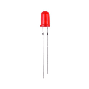

  1. Connect Arduino digital pin [3] to 1K ohm resistor
  2. Connect 1K ohm resistor to LED positive pin (+)
  3. Connect LED negative pin (-) to Arduino Pin GND

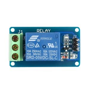

  1. Connect Relay VCC pin(+) to Arduino 5V pin
  2. Connect Relay GND pin(-) to Arduino GND pin
  3. Connect Relay signal pin(S) to Arduino Digital pin 2
  4. Connect power supply 12V (+) to Electromagnetic lock red wire(+)
  5. Connect power supply 12V (-) to relay pin(com)
  6. Connect Electromagnetic lock black wire (-) to relay pin(NO)

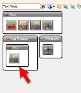

  2. Add "Binary To Text" component
  3. Add "Text Multi Source" component
  4. Add "Text Value" component

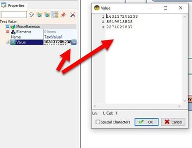

Select "BinaryToText1" and in the properties window set "Begin Text", "End Text" and "Separator Text" to empty
Select "TextValue1" and in the properties select "Value", click on the 3 dots button and in the Value window set you card IDs

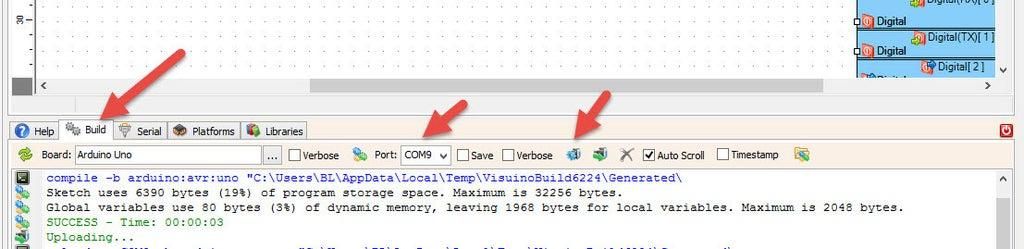

Step 7: Generate, Compile, and Upload the Arduino Code
In Visuino, at the bottom click on the "Build" Tab, make sure the correct port is selected, then click on the "Compile/Build and Upload" button.
