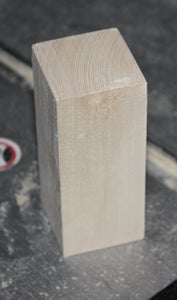

(4) Square Column 1.5" x 1.5" x 3.5"

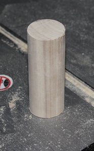

(5) Round Column 1.5"D x 3.5"

I used this fence to cut the square, the square that would become triangles, the round column and the square column.
For the square column, I had a piece of 2x4 I had previously ripped into a 1.5 x 1.5.

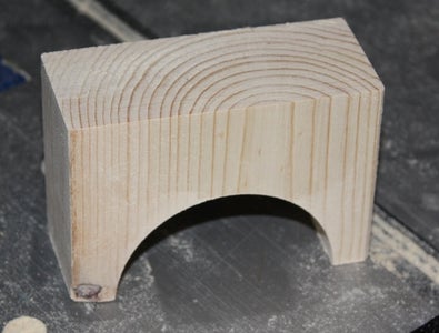

(1) Drill a 2.5" hole in the center of the block.
This can be accomplished by using a 2.5" hole drill bit. First, we need to find the center of the block. Easy enough.. just draw a line from corner to corner and find where they cross in the middle.
The drill bit I had was not deep enough to cut through a 2x4, so I had to drill from both sides. In order to ensure that the holes lined up, I drilled a 3/8" pilot hole completely through the center and then proceed to use the hole bit on each side.
Both sides should meet up and now you are ready for step 2.

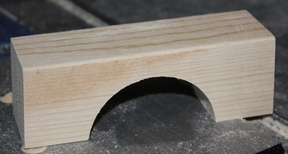

(2) Cut the blocks in half.
Using a table saw, cut the blocks in half. For a short bridge, set the fence to 2.5" For the long bridge, sent the fence to 1.75".
Get your push stick, and slowly cut the pieces in half.
Now you should have all your pieces cut out!

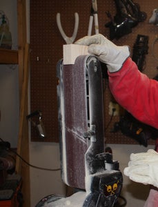

Since we don't want any splinters, it's time to sand.
You have your choice when it comes to sanding.
Feel free to use a table top belt sander ( like me ), or you can use a handheld power sander, or even a manual sanding block.
Regardless of tool, the methods are the same.
(1) Start with a rougher grit like an 80, and then move on to a finer grit like a 120. And if you want to go even smoother, you can do a 240.
(2) Always sand with the grain.
(3) Wear dust mask. Its no fun breathing in all that saw dust.
