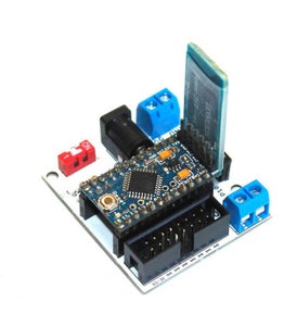

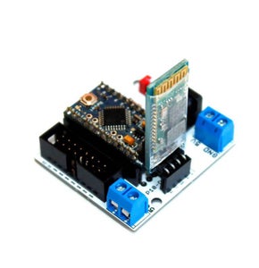

- 1 x Fully assembled SCOREDUINO-DMD module. 1 module-1 output, meaning each module provides only one output. Choose the output while placing the order. Option 2: Scoreduino module using Arduino Pro Micro
- 1 x HC-06 Bluetooth Module

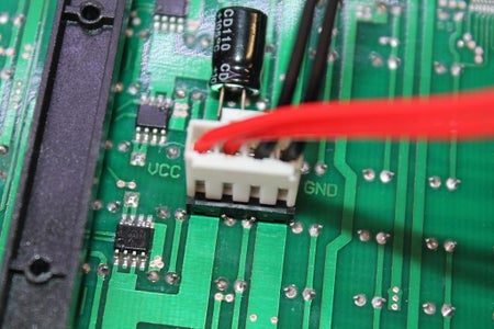

- Connect the power cable to the VCC and GND terminals on the display board. The RED wire goes to the VCC pin, and the BLACK wire goes to the GND pin.

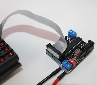

Step 2: Connect the Scoreboard Unit to the SCOREDUINO-DMD

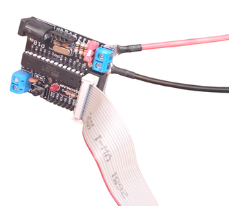

- Use a screwdriver to connect the power cable to the screw terminal of the SCOREDUINO-DMD module.
- Plug the IDC cable into the IDC socket on the SCOREDUINO-DMD board.

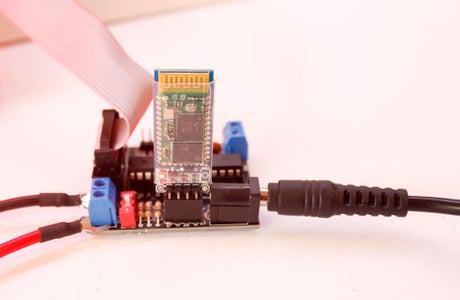

- Attach the HC-06 Bluetooth module to the SCOREDUINO-DMD board.

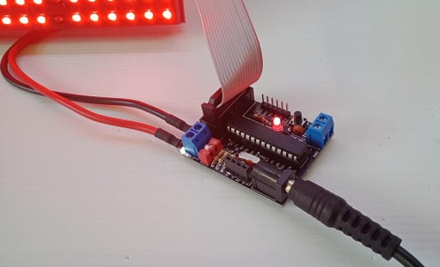

Step 3: Power Up the Scoreboard Display and Scoreduino Using 5V-6A Power Adapter
After the IDC cable and power cable are connected to the scoreboard, you can power up the SCOREDUINO-DMD module. You will see the output that you have selected while ordering the module.
