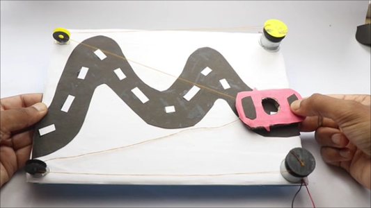

This is a string powered car racing game and we have a track at the center and the goal here is to keep the car on the track from start to end position
To control the car and maintain the car on the track we have 2 button and these buttons will drive the motor and with the help of string the car is conencted to the pulleys.

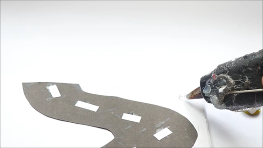

To build race track you need white and black sheet of paper, Here the road will be made with the black sheet meanwhile the strips on the road will be made by cut pieces of paper
If you are good at drawing take A4 sheet of paper and draw the race track from top to bottom keeping the sheet vertically to give no room for errors firstly I marked the race track on this white sheet later traced the same on the black sheet of paper.
Finish by adding white strips at the centre part of this road at this point our race track is ready, Now you can add glue to the back part of this black paper and add it to the main cardboard sheet.

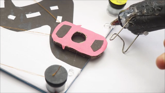

Step 2: Build Race Cara and Lift Mechanism

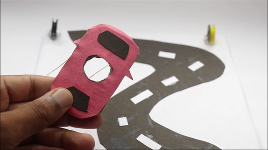

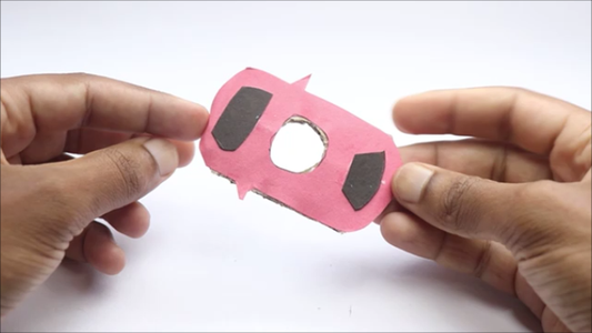

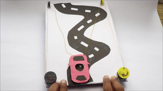

To build the race car I made the simple trace of car on a sheet of paper, I also added this small cute little Mirrors to make it much more to look like a car.
When you are preparing any design of the car make sure at the centre you have a hole so that you can have view at the road tracks when you are playing the game.

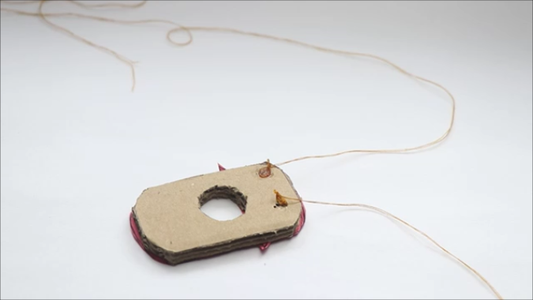

I also added the Mirror by cutting small strips of black paper, Now you can place this entire paper sheet on to a cardboard and make it look like an actual car, At the back side you just need to make two small holes and add a string.
I will be adding two separate strings, and the ends must be secured well, so I will be using super glue.

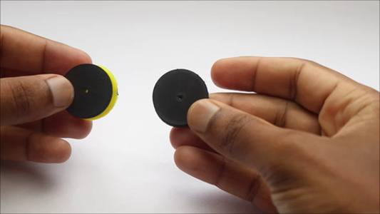

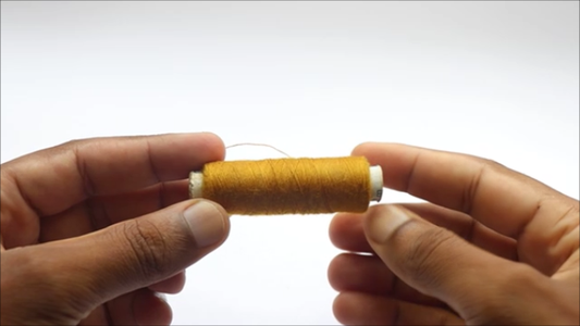

These small circles with hole at the center will control the lift and drop of the car, you can upcycle from old thread spools or simply 3d print them
To the ends at the left and right of the board glue these and now you can insert the threads from the car inside this so that their ends will go to the dc motor pully.

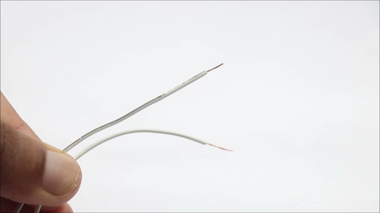

There is no much big deal with the electronics, here we are using two simple circuits that will turn the motor on and off at the press of push button.

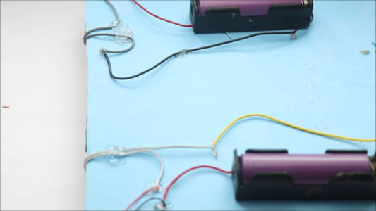

Let me give you the explanation of the circuit, From the battery holder wire connect one end to the DC motor and the other end of dc motor termibal to the push button terminal.
Now when you insert the battery to battery case and press on the push button the motor will work, Make sure to check the direction of rotation of the motor and the pulleys, i marked arrow as you can see in the step
This cicuit can then be inserted on the project and to do so add hot glue to the bottom sides as you see on the step.

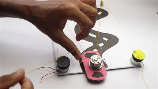

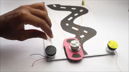

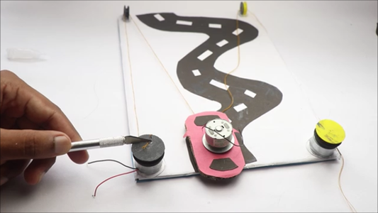

Allow to dry completely and now the car that we prepared earlier can be connected to the pulleys, Start by inserting the string to the respective slot at the top.
I rolled the string to the dc motor pulley with 4 to 5 rounds and the excess strings were cut and the ends were glued to the shaft to avoid the loosening of the string.
In the end when you keep the car on the start position the pulleys of DC motor should take the load, It simply means that when you give a small rotation to the DC motor shaft the car should move either it can be in the left or right direction if you are done with the step then we can proceed.
Before connecting the motors to battery and switch test by manually rotating the motor shaft, If this goes on well then we can proceed with next step

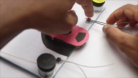

Step 4: Adding Buttons and Battery

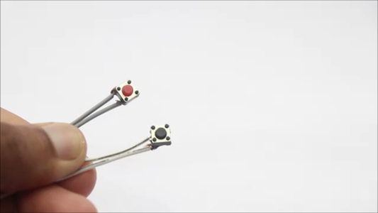

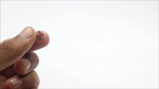

This is the most important part of the project, Here I have used ordinary push buttons.
Make a note that out of the four legs of the push buttons we are using 2 since we have a pair of pins that do the same function.
Use a generous amount of hot glue drops on the board to attach the push buttons make sure the hot glue is not too much hot nor too much cold.
We need a good adhesion since we will be dealing with a lot of pressure on the buttons at the time of gameplay.

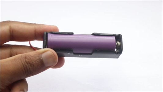

Now we can work on the back side part, I will add drops of hot glue followed by adding the battery case, Allow it to dry completely, and now you can insulate the wire connection points.

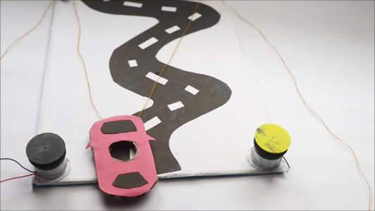

Start by turning on the battery once you insert the battery to the battery holder this project is ready and you can play the game.
Make sure the car is at the start point we have two push button left and right when you push the right button the car move towards the right on the track and the same happens when you are pressing on the left button.
Challenge here is the car should move exactly through the centre in the race track and it should make it till the end of the track, If you are able to achieve this then you are the winner.
Make a note of time taken to reach from the start to the end, Also you can add much more challenge to the game by reversing the direction of buttons.
So when you are clicking on the left the car move towards right and vice-versa this will add additional layer of challenge to the game
