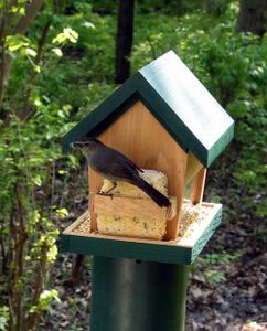

Trimming the feeder base provides a perch for the birds and also prevents excess spilling of seed (birds have no table manners).
1) Cut the base trim so it is extends 1/2" or more above the base and sand the edges to a rounded smooth.
2) Glue and nail in place.
Suet Holder
Photo #3 shows a simple suet holder that I made for my feeder. When adding a suet holder simply make it based on the size of the product need it to hold.
Roof Trim
When the roof is in set in place you may have very small gaps where the feeder ends and the roof meet (I did). The best way to hide these slight imperfections (while also creating a better seal) is to attach small pieces of trim to the feeder ends or roof. As seen in photo #4, I added trim to one side of the roof which also helps hold the roof in place a little more securely. On the other side I attached the trim to the feeder end. Both pieces of trim hid the gaps and eliminated the chances of moisture entering the feeder in a heavy rain.
Staining the roof will help seal the seam at the peak of the roof and is highly recommended. A small sample can of stain mixed at my local home center cost under $4. I also decided to stain the outside of the base trim just for the sake of appearance.
Step 7: Mount the Feeder, Sit Back and Enjoy
Bird feeders can be mounted in a variety of ways. However, mounting your feeder on a metal pole is really the best method and it really isn't that difficult to do. Buy a pole and set it in a hole with redimix concrete. Have the pole extend to a height of about 5 feet above ground level. Then be sure to attach some form of a shield (see photos for one example) to stop small animals from climbing the pole and raiding the feeder. However, if raccoons are present, applying a thick coating of lithium grease to the pole will be needed to discourage these more clever and determined creatures.
Finally, with the feeder mounted and filled with seed and suet all you have to do is sit back and enjoy the view. Rest assured, IF YOU BUILD IT THEY WILL COME!
