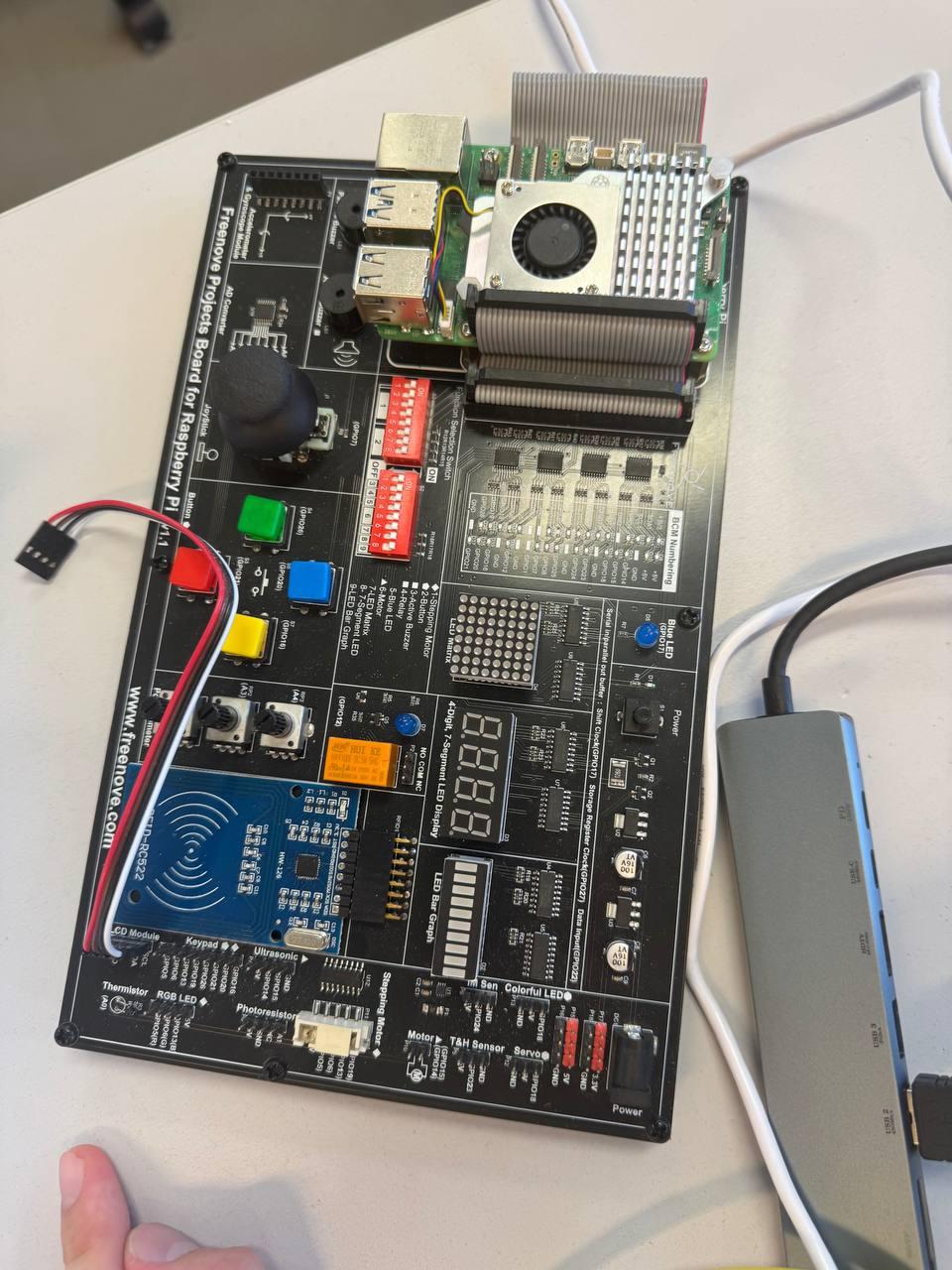

Hardware:
-Rapsberry PI 5(kit) -120 eurp
-MicroSD card (16+GB) - 8 euro
-Rapsberry PI power supply - 12 euro
-USB camera - 10 euro
-Freenov Project Kit - 165 euro
-Jumper wires - 100 10 euro
-GPIO buttons - 0.5 euro each
Software:
-Rapsberry Pi OS
-app.py - script for laptop
-main.py - script for Rapsberry PI5
-resnet152v4.pth - AI trained module
-BLE communication code on both rapsberry and laptop

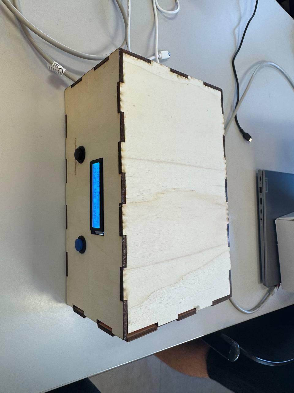

Step 7: Maker Skills
To create a custom enclosure for my Freenove project kit and Raspberry Pi, I used laser cutting.
  1. Box Design:
  2. I designed the base structure of the box using MakerCase.com, which allows you to generate laser-cut box templates that fit together like LEGO pieces.
  3. Customization:
  4. After generating the basic box layout, I imported it into Adobe Illustrator to manually add:
  5. Cutouts for buttons
  6. A window for the LCD display
  7. Ventilation holes for airflow
  8. Assembly:
  9. I laser-cut the finalized design from wood (or acrylic) and glued the parts together.
  10. One side of the box was left removable, allowing easy access to the Raspberry Pi for maintenance or upgrades.
