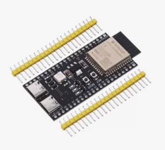

- ESP32-S3 DevKitC-1 (WROOM N16R8)

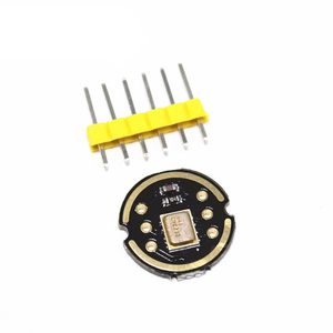

- INMP441 Digital Microphone

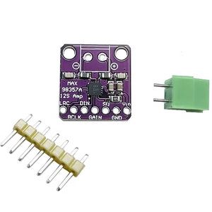

- MAX98357A Digital Amplifier

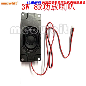

- Speaker (8Ξ© 2

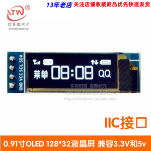

3W or 4Ξ© 23W) - 128x32 I2C OLED Display

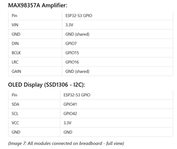

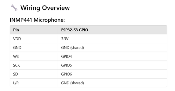

Step 1: π§ Wiring Overview

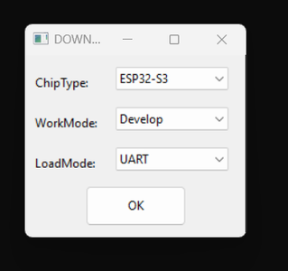

Step 2: π» Firmware Installation

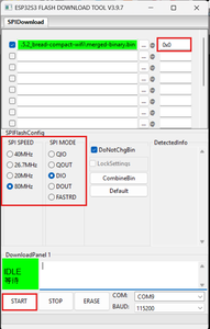

Recommended Firmware:
Use: v1.4.6_bread-compact-wifi.bin (Stable version for OLED 128x32 SSD1306)
- Download from xiaozhi GitHub Releases
- Flash the .bin file using ESP32 Download Tool or esptool.py
- Press RESET after upload to start

- No response? Ensure microphone GND and L/R are connected properly
