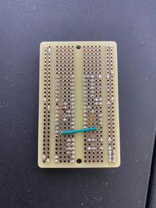

  • Lay out your components on the through-pin bread board before you start soldering to make sure you have enough space before you begin soldering
Step 2: Construction
  • To begin construction, I found it to be the easiest to solder on you 28-pin IC socket first and begin adding the components accordingly
  • Make sure to not insert the ATMEGA328-P IC until after you have finished soldering all components to make sure you do not accidently damage the IC from the heat produced from the solder wick and soldering iron
  • If you have it available, you can use Kapton tape to hold down your headers/components since it resists heat very well and will not melt or leave residue onto the components
  • Try to avoid soldering the majority of your wires on the bottom of the through hold breadboard as the wire can melt easily and can potentially cause a short circuit and damage the board

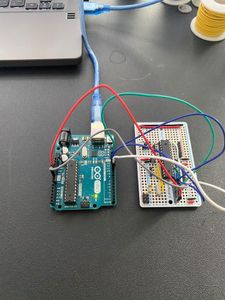

Step 3: Burning the Bootloader
There are multiple ways to burn the bootloader onto the ATmega328. For instance, through installing computer applications such as Mini-core or using an AVR ISP shield. Although all will be able to successfully burn the bootloader, the simplest way is through using another microcontroller (such as an Arduino Uno or Mega) and using the ISP to communicate between the two devices; as documented in the link below provided by Arduino.
https://docs.arduino.cc/built-in-examples/arduino-isp/ArduinoToBreadboard
