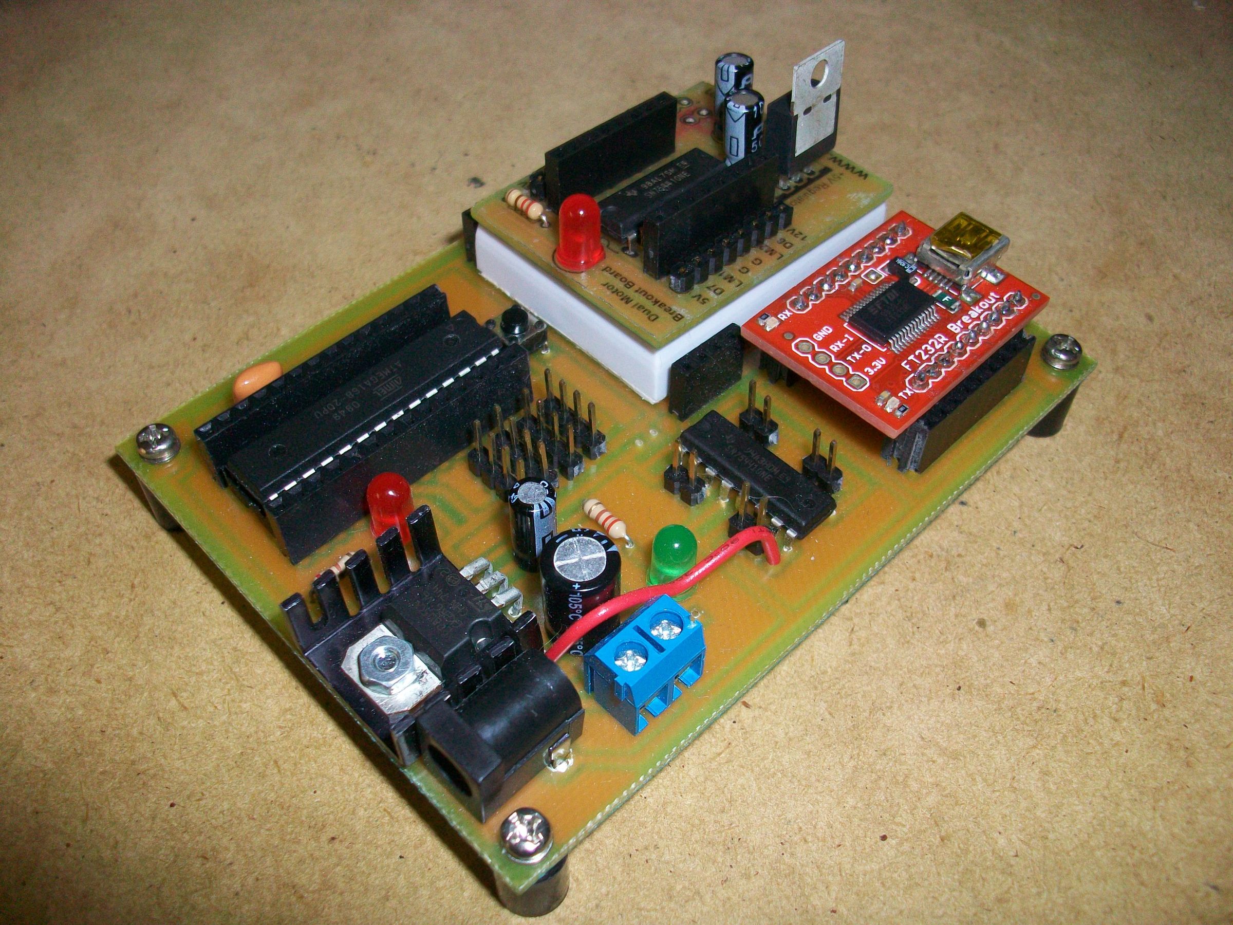

Step 6: PCB Files
If anyone is interested in etching their own PCB (printed circuit board) I have included the component and solder side pcb files.
I have added a zip file which contains 300dpi JPG files of the component side and solder side.
If you have questions, feel free to email me and I will help you out the best I can. Just note I have classes throughout the day, so sometimes my replies can take a day to respond.
