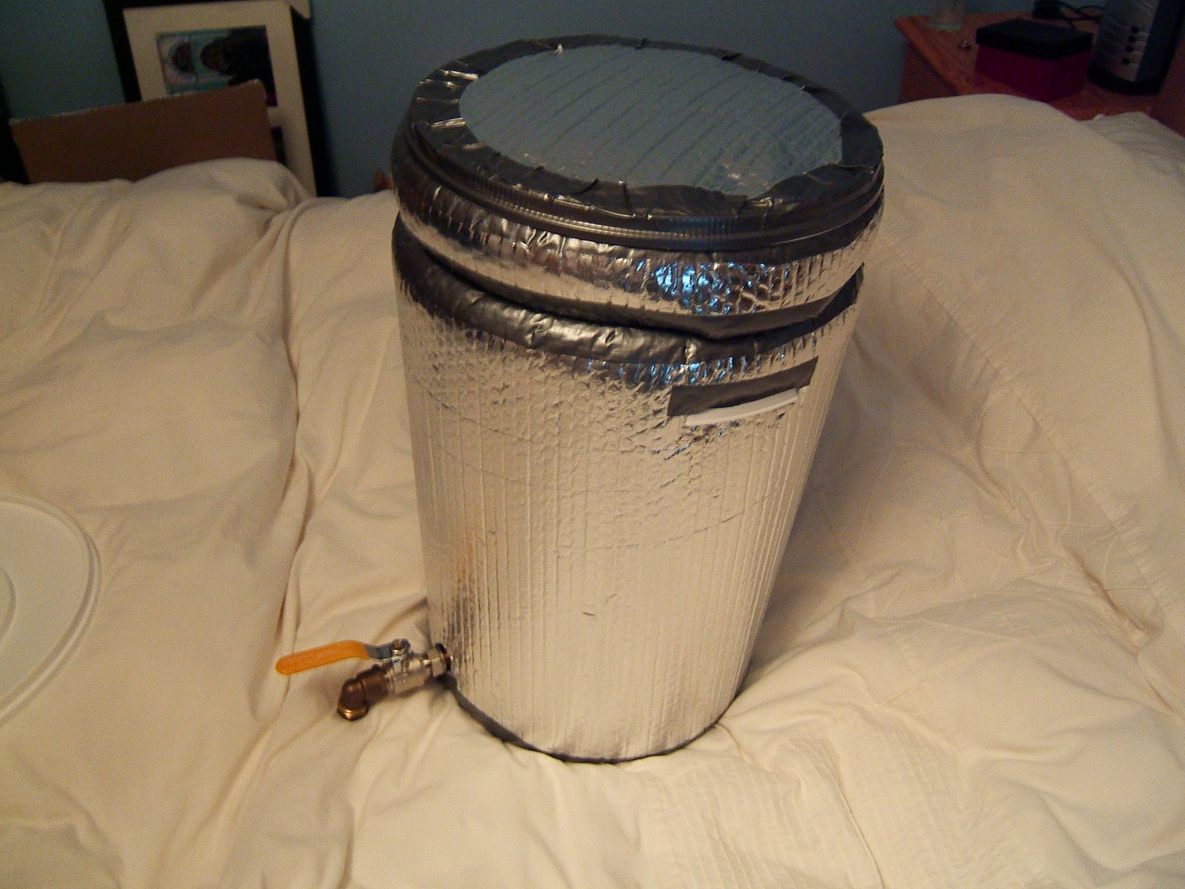

Step 5: What Can You Put in a Bucket to Make It Weigh Less?...HOLES!!!
You will need to make one 20mm hole for the tank connector like you did for the mash tun. You can have a siphon effect going so it doesn't have to be right at the bottom but likewise you don't need it right at the top. i did mine maybe 15cm up.
You will also need to make two holes for the elements. For my elements I made a 38mm hole using a borrowed hole saw. I positioned the element holes close together on the opposite side of the tank connector hole about 9cm from the bottom of the bucket to the middle of the hole. Neaten up the edges with a craft knife or similar.
The reason for the elements being on the same side is that then when heating the liquid convection currents should help to stir the liquid up ensuring even heating.

Step 7: Plumbing Without the Pb
Did you know that the word plumbing comes from the Latin name for Lead, 'Plumbum', as pipes used to be made of this toxic metal? ...You did?! ... oh... fine.
I didn't take too many pics here I'm afraid but look at the STEP 1 to see how I did this for the mash tun as the principle is the same.
1 - Tank connector pointing in through 20mm hole with washer on the outside, tighten. Pass through a short piece of pipe and attach the tap onto the outside. Its all compression fitting so you'll need 2 spanners/wrenches to tighten all the bits up.
2 - Add tiny bit of copper pipe then a 15mm compression elbow to point down to the bottom of the bucket. Then add a bit of pipe to reach almost to the bottom of the boiler. Then add another elbow (i tried using a push-fit fitting in this pic but preferred compression fittings) and connect that to the hopstopper. The idea is to get the hopstopper running as close to the bottom of the bucket as possible to reduce dead space in the boiler.
3 - All connected up with a bit of copper on the outside of the tap to achieve a siphon effect. I tried this all out with water and it was water tight 1st time (unlike the mash tun)!
Notice that in Pic 2 I haven't drilled the element holes or finished the hopstopper. That's because I didn't really know what I was doing and made a lot of this up as I went along (with lots of help from forums and friends).
