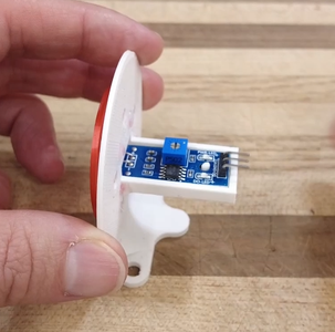

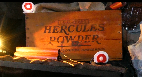

To start off, we will make the targets. We wanted these to be laser activated so decided to use photo sensors. Because a laser is just an intense focused beam of light, these should work really well. The advantage of a laser is that targets can be very close together. The bad thing is that the laser has to hit the center of the target or the Fresnel lens. So accuracy is more important, and I think that makes it more fun.
Step 2: Target Assembly

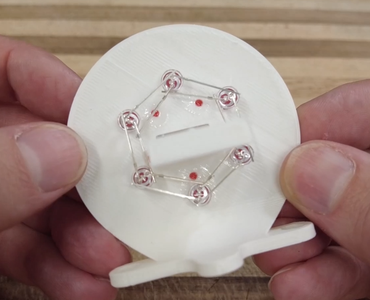

We created our own design for these targets because we wanted them to light up at night. I printed the base out in white and the outer ring in red to make it look more like a target. We glued the red ring to the base then added the photo sensor and the white LEDs.
The LEDs are all in parallel, so all the negative legs are connected and all the positive legs are connected together. The makes them all receive the same voltage across them. We also added a 120ohm resistor inline so they don't pull too much current.

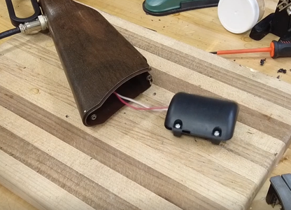

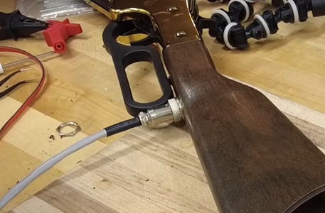

Step 3: The Laser Gun
For the laser gun we modified an old style BB-Gun. There are only a few steps for this but took me a while in real time so I don't want to make it sound easier than it is.
First thing I did was find a location for the trigger to activate a switch. Luckily this BB-Gun has a little platform I could mount a small push button switch. If fit perfectly and I didn't have to modify anything aside from gluing the button down. SOOO lucky!

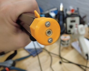

Next thing we did was print out a new tip in orange PLA and push a little laser into it. These lasers are really cheap and you can get 10 for about a dollar each. Unfortunately, the lens on the laser wasn't straight so we had to add some adjustments. I did this by adding screws to the tip so you can get everything lined up. It worked really well. The tip used M2 screws with threaded inserts.
If you'd like, you can also add some haptic feedback like a vibration motor. We did this and it seemed like a great idea but it made the laser shake too much and hard to hit the target, so we actually turned it off.
Final step is adding a connection from the gun to the controller. I used aviation style connectors for this and a 5 conductor cable. I guess you could use ethernet cable too if you are not using the haptic feedback which may pull too much current for those thin wires.

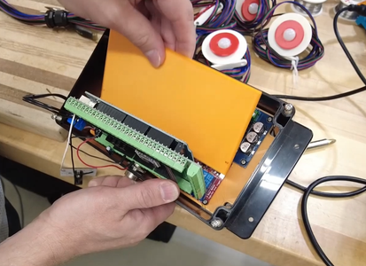

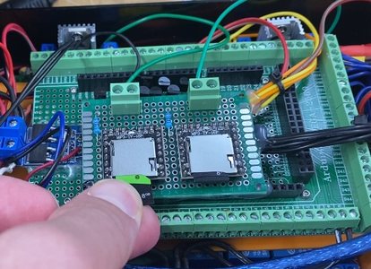

Step 4: The Controller
Well this is the craziest part of the build because we have to smoosh a lot of components into a little project box.
  1. Mega 2560
  2. Mega 2560 expansion board
  3. 2x MP3 players dfPlayers
  4. 2x 100watt audio amps
  5. Relay board with 8 channels
  6. MOSFET switch
  7. 8x NPN transistors
  8. Remote control switch
To get everything in, I stacked the components.
I created a bottom layer plate that I could put threaded inserts into, to hold down the audio amps and the relay board. I then added a second deck on top of this to add the mega 2560 with the expansion board.
On top of the expansion board I added 2 MP3 players and the 8 NPN transistors. We need transistors to act like switch for this project because all 8 targets on with the lights pulled almost 800ma and the Mega 2560 can only handle 200ma output power on its digital IO.
If you are using a haptic feedback then you should also add in a mosfet switch to handle the current of the the motor which will be about 2amps.
The power input was 12V, so we had to use a 5V regulator to not damage the Mega, photo sensors, or the LEDs

Step 6: Add Audio Effects

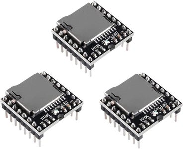

One very interesting thing about the DFPlayer MP3 players and the audio amps is that you CANNOT connected the negative sides of the audio out to the amps. For some reason this will blow out the MP3 player. So I just had the positive side of the audio out from the audio player going to the input of the amp and it worked fine. Some mysteries I'll just go with. You can see this in the last picture with the green wires (positive), no negative side connected.
For power I used a 10Amp 12V power supply because of the 100watt audio amps can pull a lot of amps. They are VERY loud. I connected the output of the amps to 6" speakers.
One speaker played gun sounds while the other played prop sounds. We have two MP3 players so we can play 2 sounds at the same time. Otherwise when a new sound starts, it will interrupt and stop the current sound playing.

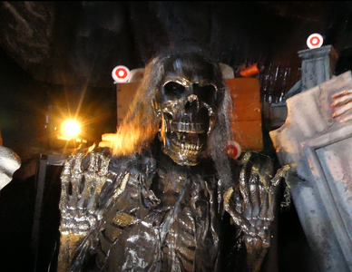

Step 7: Connection to Props
Most of the props we used were mechanical already so they had movement when plugged in. Just no sounds but we added that in the last step.
The relay board can handle 120AC too so we just cut one side of the cord going to the prop and connected it through the relay. Then adjusted the timing of the software to activate the prop for a set amount of time. Otherwise, the props work as normal, we just control when they get power.
