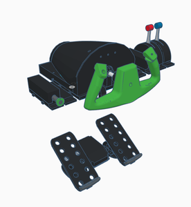

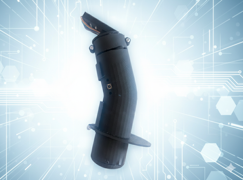

Step 1: The Mechanical Concept
I'm no engineer but I wanted to create the mechanics for the controller based on my own ideas. Limiting myself to linear potentiometers I came up with a drive using a set of rotational and linear gears to translate Yoke rotation and pull/push motion into linear positions. The pictures should show the function of this setup.

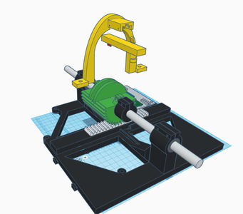

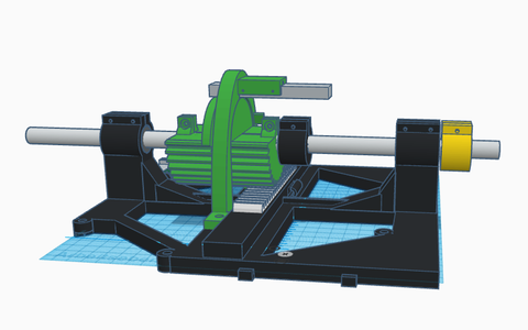

When the yoke is pushed or pulled, the pitch potentiometer handle (red) is moved in the same direction guided by the upper part of the main gear (green) guard rails allowing for a simultaneous rotation of the main gear. The main gear glides above the bottom linear gear in perpendicular direction without moving it.
Only a rotation of the main gear will drive the linear bottom gear (black) and move the respective roll potentiometer handle (red).
I included a spring fixture on the base and on the rod to have the yoke return to its center position if no control input is applied. The middle rod fixture will be pushed back to its origin by the springs (yellow arrows) if yoke is turned or pulled/pushed (red arrows).

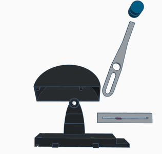

The linear and rotational levers for things like thrust or flaps are also utilizing linear potentiometers. The linear and rotational lever baseplates can be attached to either side of the yoke base plate and can be stacked - so I'm free to add up many levers for all sorts of controls such as air brake, landing gear, etc.

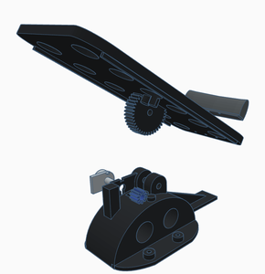

As for the rudder I used a parallel set of levers to keep the pedals straight. Yet I use the same way to transform the pedal shift into a linear potentiometer setting as shown in the picture. If the pedals are shifted the potentiometer handle (red) is being moved likewise. For my purpose I used an additional arduino not to have to connect the poti of the rudder - on the floor in most cases - to the board of the flight yoke - on the desk in most cases. This gives some more flexibility but uses one more USB port of your PC. It's also possible to connect the poti via an appropriate 3 line cable to the yoke pcb.
Furthermore I included a measurement of the angle of the rudder pedal for wheel brake and potential racing car throttle and brake function. The pedal rotation is transferred to a poti via a gear set. The pedal is pushed back up by double springs as I did not have stringer ones available.

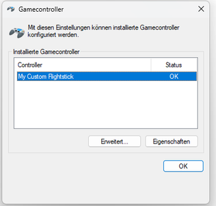

Step 2: Signal Readout Methods - Micro Pro Native HID, Mobiflight for MSFS Only or VJoy for General Usage
After the mechanical concept is done to translate the control input into mechanical potentiometer settings a platform is required to measure and translate these settings into MSFS (or other applications) inputs. Initially I started this project using Mobiflight to readout the poti values and feed them into the MSFS. However even Mobiflight Developers say that using raw poti readouts as flight controls is not really the sweet spot of Mobiflight.
Edit: research helps... I updated my design to cater for an aduino Pro Micro which can behave like an HID when plugged in. So my current version does not need Mobiflight or vjoy. Just a proper joystick.ino to send the right outputs based on the steering inputs. I have updated the PCB also to enable Pro Micro and to include I2C for multi purpose and an RJ10 connector for daisy chaining for later extension. Find the PCB and .ino details on github. Just note that the connectors from the Poti have now a different connectivity - (Vcc - Arduino Pin - GND).
Nevertheless you can use Mobiflight for this job greatly. In a nutshell it programs your arduino, reads the analog ports and sends the measurement values after some processing to the right MSFS variable. Same is possible reading out MSFS values and create outputs to LCD or other devices - e.g. LED, stepper motors and so on. The web page provides all relevant turorials and info to setup and configure the platform.
For prototyping a breadboard setup with directly connected potis can be used before proceeding with further steps. As soon as the arduino is connected and the potentiometer values are being measured at the respective analog inputs the configuration for MSFS is really simple.
A handy web page providing a tool to create an min/max value adjusted so called "preset code" for the configuration can be found here. Later, you just have to enter your measured max and min values for the potis to adjust to the correct range and direction when you have your final assembled controller ready.
To be able to use the controller also for other purpose than only flight sim - like racing - I did some more research and found on github vjoy and yjoy-serial-feeder, a combo which does the job in a more general way.
Vjoy is a virtual joystick that mimicks a configurable, multi-Axis, multi-buton joystick. Using a simple arduino program (joystick.ino) it creates an IBUS channel stream out of the analog and digital readings of the Arduino and streams it to the serial com port. With the vjoy-serial-feeder the channel stream is read and assigned to the customizable Joystick axises and buttons of the vJoy device. Furthermore you can map the signals to more sophisticated non-linear behaviour with dead zones and much more. Download the vJoy installer from here and start installation. Download the vJoy-serial-feeder from github and follow the installation manual.

Base Plate: The base plate keeps the moving and non-moving parts in position. All other parts will be fixed to the base plate, respectively parts fixed to the plate. It needs to be printed in normal orientation (starting with the bottom of the plate)
Linear Gear: The linear gear is used to translate roll inputs via the yoke into a linear move of the poti handle. It has two guard rails that will guide the poti handle. This gear will make less noise when used in the controller if printed upside down. No support, nor brims should be required.
Board Adapter: To enable different microcontrollers I introduced an adapter board. This will hold the arduino circuit PCB. Print in normal orientation.
Main Roll-Pitch Gear: This gear translates push/pull control inputs from the yoke into pitch poti setting and transmits roll inputs from the yoke into left/right move of the roll poti handle via the linear gear. Print as Tower with tree support to keep the guard rail overhang as clean as possible.
Max Pull Fixture/Max Push Fixture: Just a fixture on the rod to limit the range of pull and push input. Print as tower with least support.

Linear/Rotational Lever Plate: Used for linear poti to be controlled by a push/pull lever through a ball bearing or a push/pull rotational lever. Print in normal orientation.
Linear/Rotational Lever Cover: A cover respectively for linear or rotational levers may be used to protect the inner wokings. Print upside down for linear and on flat side for rotational cover. Minimum suport, use trees to keep surface clean.

With all the parts assembly is not so straight forward. The pictures shows the order of the parts to be assembled highlighted in yellow for each step:
  1. Place Base Plate
  2. Mount Roll Poti in space under base plate, look for poti handle to be in center
  3. Mount Linear Gear, place poti handle between guard rails of linear gear
  4. Mount Board Adapter Plate
  5. Fix Arduino PCB on Adapter Plate
  6. Connect cables from Roll Poti to Arduino PCB, make sure you are consistent with 5V, GND and variable resistor contact
  7. Mount Main Roll-Pitch Gear and insert rod
  8. Adjust Roll Poti to Main Roll-Pitch Gear - should be symmetric without left or right displacement
  9. insert ball bearings
  10. Mount Pitch Poti on Pitch Poti Fixture Arc and mount Arc on base plate. Now adjust pitch mid point, so that Main Gear is central over Linear Gear and poti handle is central to poti. Connect the cables from pitch poti to Arduino PCB, make sure you are consistent with 5V, GND and variable resistor contact
  11. Mount Max Push Fixture
  12. Mount Yoke fixture and Yoke - needs to be aligned with Main-Roll-Pitch gear center position
  13. Mount Cover Stabilizer
  14. Mount the base spring fixtures left and right and the rod spring fixture. Fix with screws and adjust to have the springs relaxed in center setting.
  15. Mount Main Cover
  16. Mount Front Plate
  17. Mount Controller Fixing Screws

Step 6: It Works!
Step 7: Some Afterthoughts
Designs are never final, changes are always required, dependencies are requiring further changes and will be missed inevitably if there is no quality management being done. So guess what happens in such a DIY project.
The final outcome has yet surprised me as really usable flight controller and together with the virtual headset it is hell lot of fun. So far I did not make broad use of the rudders as I do not yet have a decent idea how to fix the rudders to the floor without destructive screws in my nice wood panels - mabye a larger dedicated wooden board? But then the assembly/disassembly becomes less lean - more thoughts on that required.
Obviously the resilience of this gear is not as good as that of a purchased one - but you can tweak it and build and change and... extend it as you like. And it is self made!
