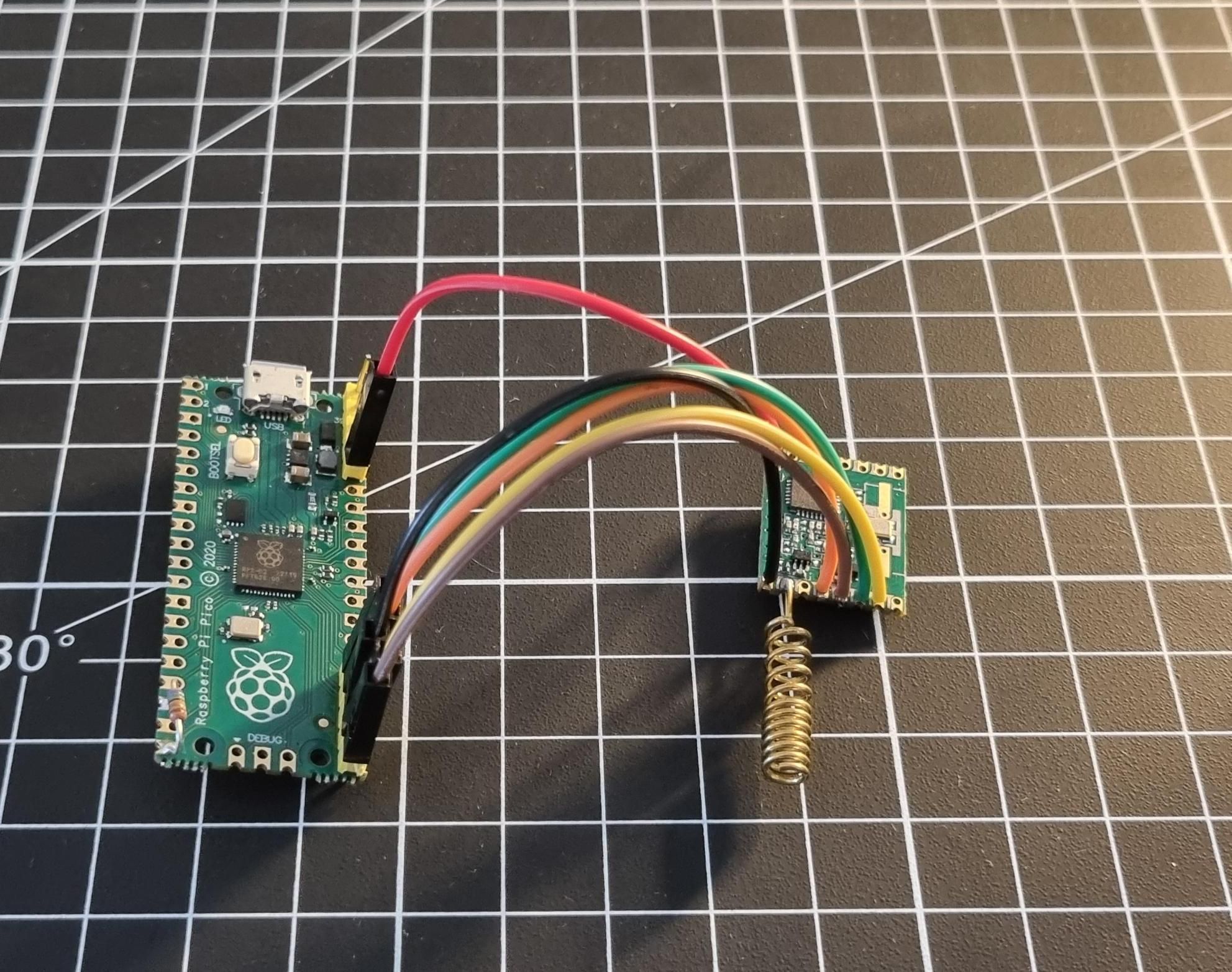

Introduction: Build Your Own Mioty® Demo Kit Using Only Off-the-Shelf Components
mioty® is a robust, low-power wireless protocol designed for massive IoT deployments. While commercial development kits exist, it is entirely possible to build a fully functional mioty demo node yourself using standard components and an open hardware PCB.
In this Instructable, you will build a working mioty demo kit based on a Raspberry Pi Pico and a HopeRF RFM69 module. It is basically a breakout board for the Raspberry Pi Pico, where the Raspberry Pi can be removed, in case you need it for a different project as well.
In this demo, we will order the PCB, solder the components, and upload a simple demo firmware that sends data over mioty.
This project is suitable for makers with basic soldering experience and some familiarity with Arduino-style programming.

  10. SMA antenna connector. Alternatively, there is a connection foreseen for a coil antenna, but this will give you a worse RF performance.
Pay close attention to:
  1. Orientation of the RFM69 module: The ANT-pin should be closest to the antenna, that's an easy way to check the orientation.
  2. Proper ground connection for the SMA connector (also solder on the back side)
  3. Clean solder joints on SPI pins
