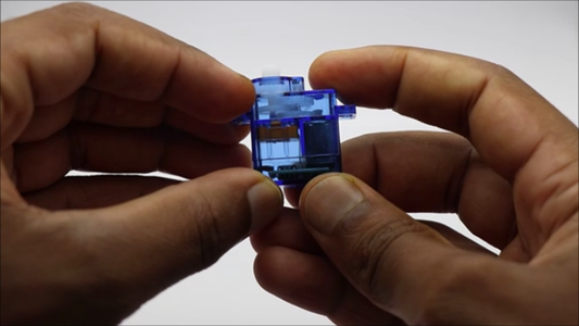

Step 1: Modifying Servo Gears

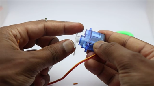

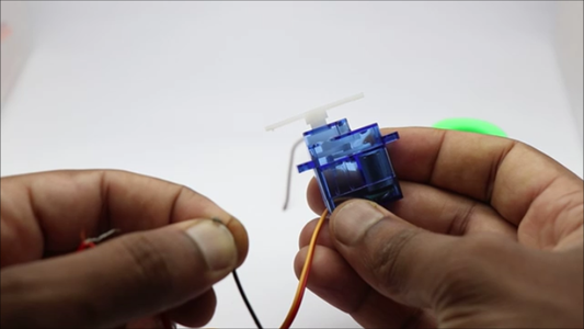

Like I said earlier I will be modifying a 180-degree rotation servo to a 360-degree servo, This can be done in a very simple way.
Hold on to the reading, I will make you understand here, if you still have any doubts you can check for the visuals or the video.

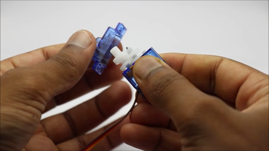

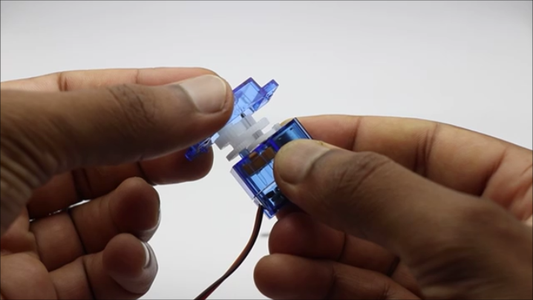

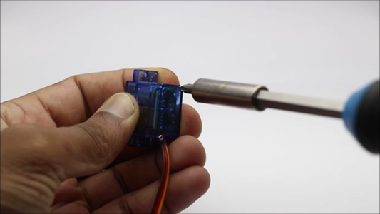

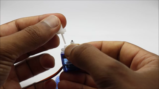

Start by loosening the screws given at the base of the micro servo.
If you have a Philips/star-shaped screwdriver almost your work is done.
Remove the screws, there will be only 2 screws, after you remove the screws remove the top lid of the servo.

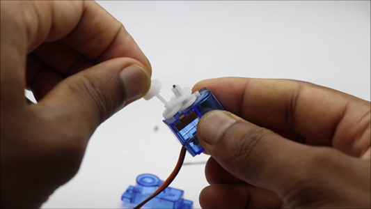

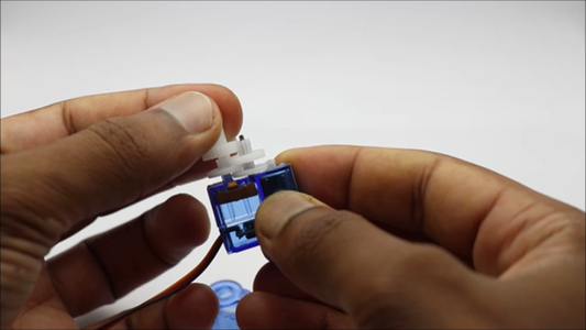

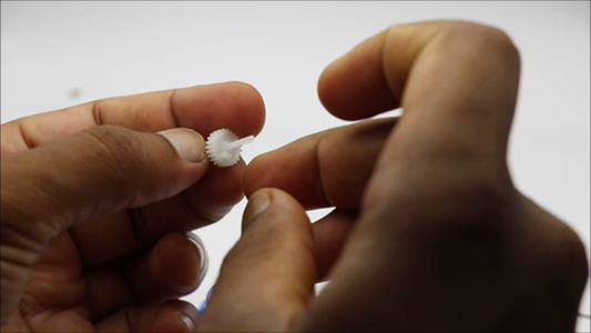

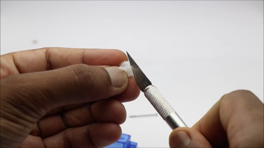

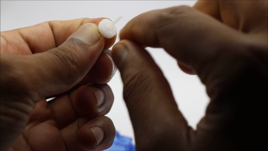

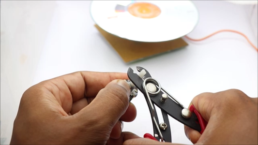

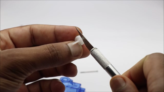

In the top lid, you can see the set of gears, here we are working on only one gear that is on the top,
Remove that gear and at the base of the gear you can find a small hump, remove the small hump and reinstall the gears.

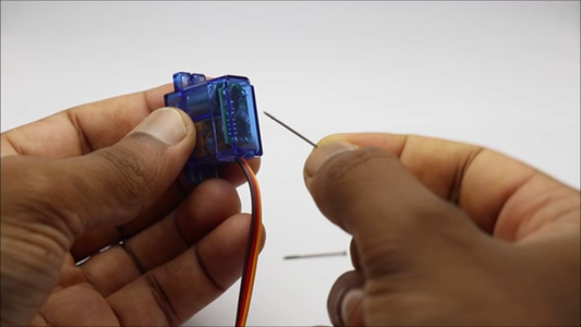

Step 2: Modifying the Motor
After you have modified the gears we can head over to modifying the motor.

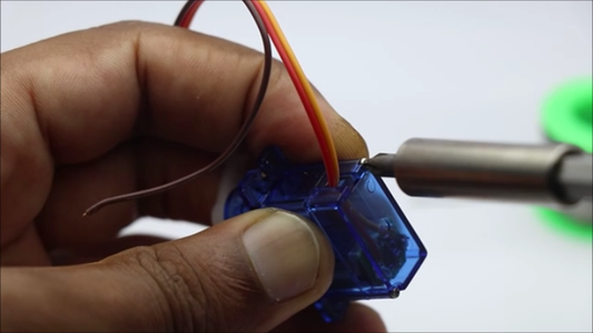

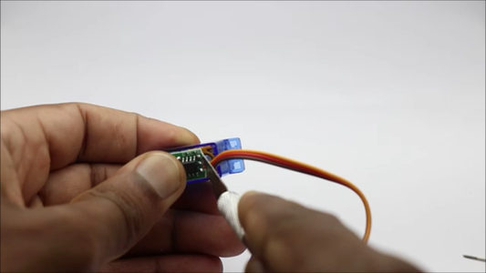

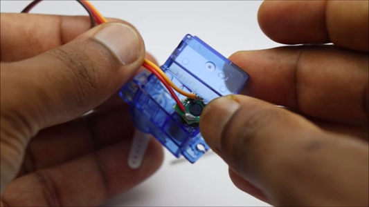

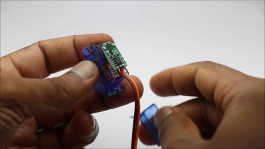

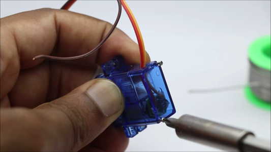

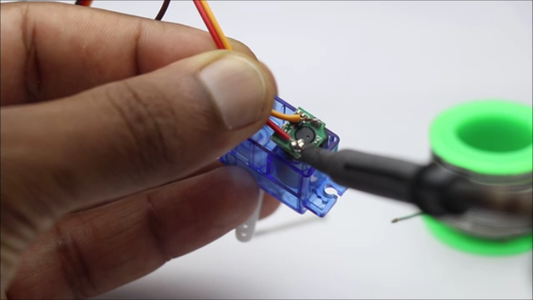

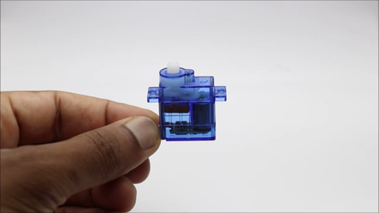

As you are done with the top part now remove the base lid of the servo, there will be 3 wires running here.
trim that wire from the chip, I have cut the circuit an this is an optional part, You can directly solder the wires to the motor terminals.
Remove any one wire so that we have only 2 wires now, one for positive supply and one for negative.
End of this step close back the lids and add screws, now add a servo horn if you have just to check if the 360 rotation has been enabled,
Provide power supply from battery to the motor, now that motor should be able to make 360-degree rotation.

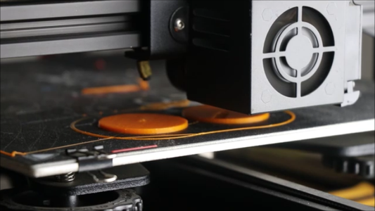

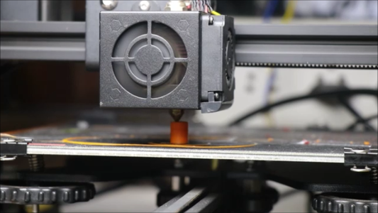

Step 3: 3d Printing

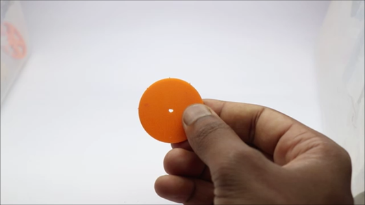

To make a proper fixture between the motor and the rotating disc I designed a simple circle taking account of the CD dimensions.
I have provided the setting that I used here for the parts, you can use PLA to print the parts.
The knob of the potentiometer went missing so I had to design a new one and print it, if you already have a knob you can skip this part of the 3d print.
It took me only 20mins to print the part, if you want the stl for printing i have given them below.

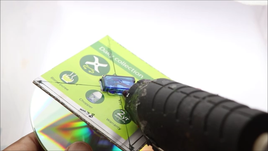

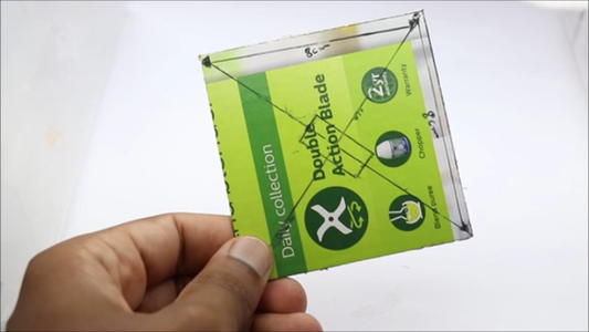

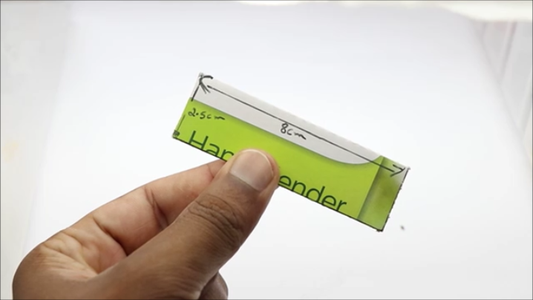

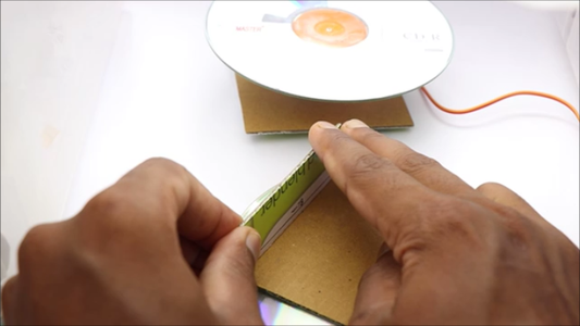

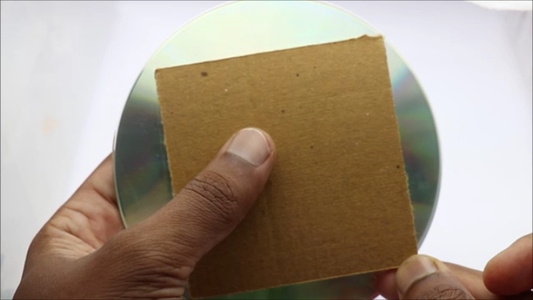

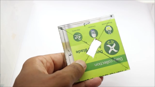

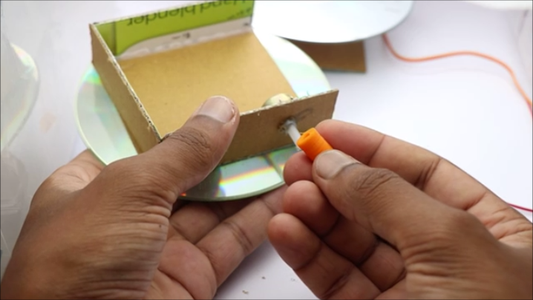

Step 4: Servo Holder

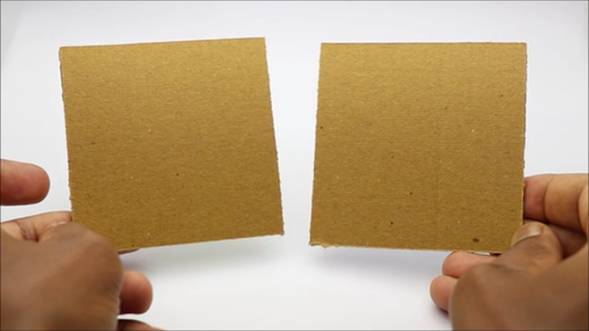

We need a secure holder that can hold the servo intact.

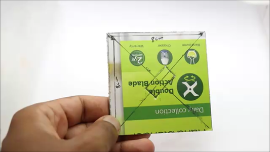

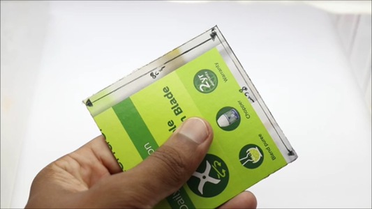

You can just cut the square pieces of cardboard as I did, you can follow exact same dimensions.
To make the servo holder I made a hole in the center to which we will glue the servo in further steps.
For the sides also there are measurements and you can see those in this step visuals.
Cut these pieces and later we can glue them together

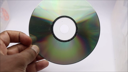

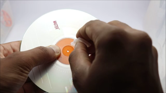

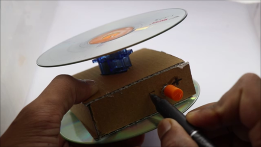

Step 5: Preparing the Turntable
This is the important part because here we are dealing with the rotation, if the alignment is not good there will be a disturbance in the rotation.

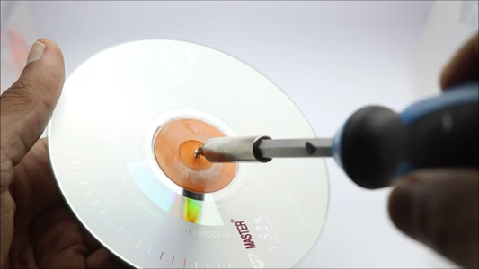

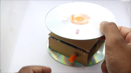

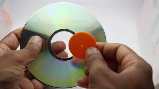

So be a little careful in this part, I will start by adding the 3d printed part to the center of the cd
Use drop of superglue to fix it to the center.

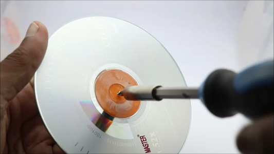

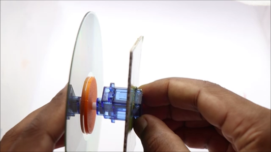

I found the screw for this from the servo horns of the motor.
use the start screwdriver to fix these to the horns of the servo.
Now like I said earlier add the servo to the square base.
Now test if the table spins properly, it will! if you followed the above steps.

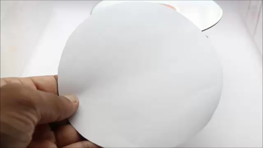

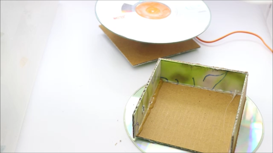

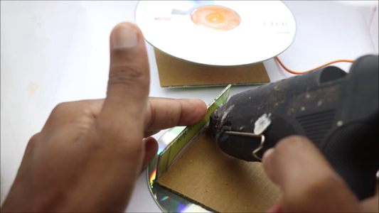

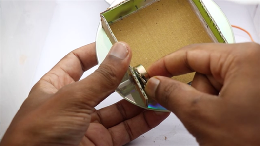

Step 6: Base Part
I found that using CD for the base would make this project look a lot cleaner.

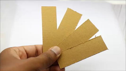

But merely using the CD would not look good so I added the pieces of cardboard that would form a square.
The combination of all these will provide better stability for this turntable as we are adding the battery to the base which in turn adds weight.
Use the simple steps to add the squared sides.

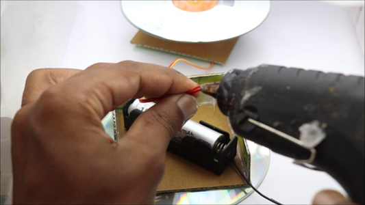

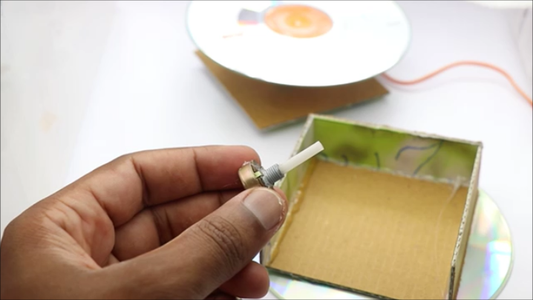

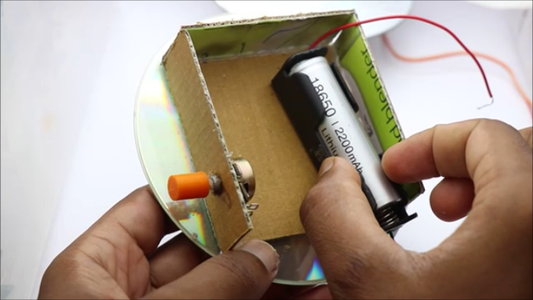

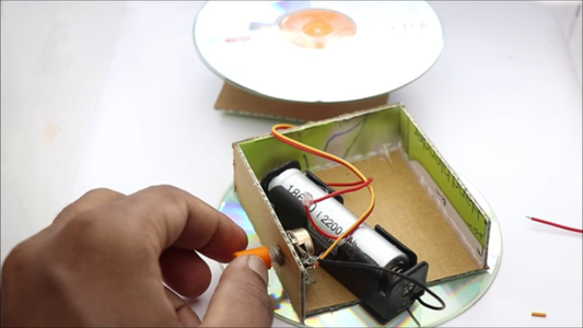

Step 7: Assembling the Circuit

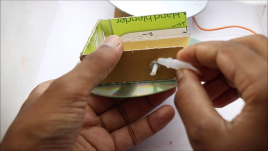

Follow this simple circuit for this project, the potentiometer has 3 terminals and the middle one is common.
Connect one end of the motor to one end of the batter, the other side of the terminal one from the battery, and one from the motor will be connected to the center and one on either end of the potentiometer.
Now after you make a simple square using the pieces of cardboard and gluing them together attach the potentiometer to the side and later add the knob.
Place the battery and insulate the wire connections.

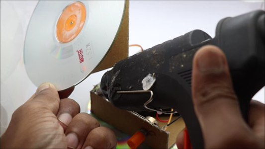

Finally, add glue to the top part and glue the top part.
Wait some time for the glue to dry completely.
Now you can start to record the objects in 360, if you have any questions regarding this project comments box is always there to connect us together.

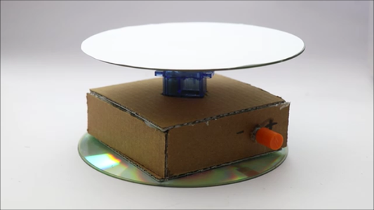

Step 8: Finishing
Secure all the gaps with hot glue and leave one side free to remove the battery and recharge.

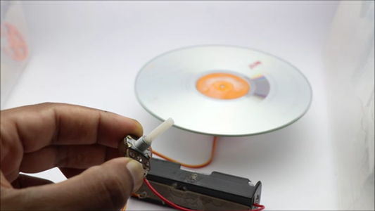

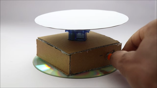

How to use this turntable?
It is very simple, Place the color of the background, in my case, it was white(on a4 sheet), and place the object over it.
Gently turn the potentiometer until the desired speed of rotation meets your needs.
You can start to record a video, After the video is recorded, turn off the device by slowing down the potentiometer to zero and then removing the battery.
You can charge the battery and put it back again and use this.
But as per my test a full charge, you can complete multiple video shoots.
