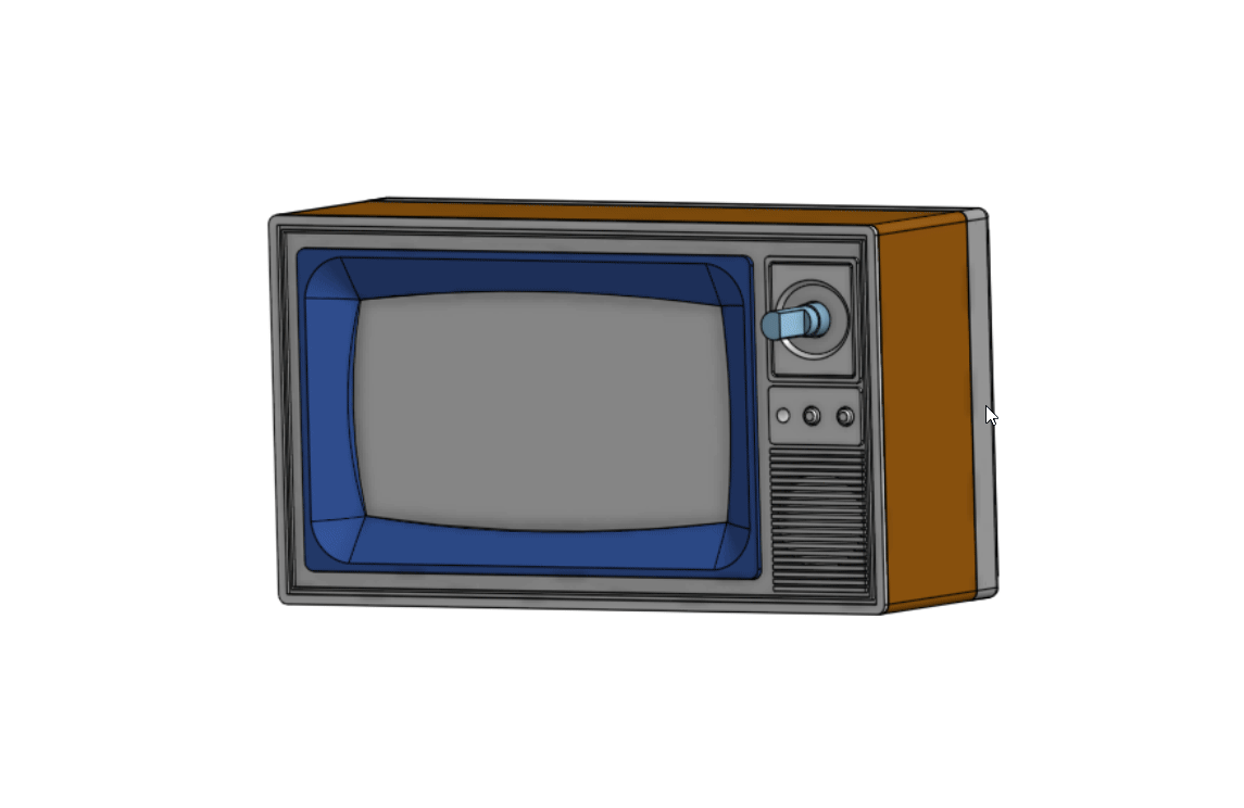

Design & enclosure
The visual goal was to evoke the look and proportions of small 90s CRT TVs without being a bulky full-size set. The enclosure is 3D printed with snap-fit joins and uses M3 screws for the parts that need serviceability (screen, Pi, speaker, encoder). I designed internal mounting points for neat cable routing and easy removal of the Pi for maintenance.
I uploaded the 3D files to MakerWorld so other makers can print their own shells or adapt the design.

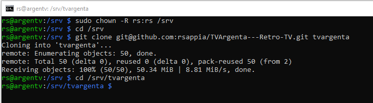

Step 2: Clone the GIT Hub Repo
Now let’s prepare the directory where we’ll clone the repository.
The folder /srv usually exists by default, but if it doesn’t, you can create it:
sudo mkdir -p /srv
Next, give ownership of that folder to your current user (replace rs with your own username).
This allows you to write inside /srv without using sudo all the time:
sudo chown -R rs:rs /srv
Option A – Clone using HTTPS (easiest)
This is the recommended method if you haven’t set up SSH keys in GitHub.
cd /srv
git clone https://github.com/rsappia/TVArgenta-Release.git tvargenta
cd /srv/tvargenta
Option B – Clone using SSH (for advanced users)
Use this if you already have an SSH key configured in your GitHub account.
cd /srv
git clone git@github.com:rsappia/TVArgenta-Release.git tvargenta
cd /srv/tvargenta
Should look something like this:

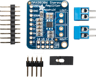

Step 7: Audio Setup
For the audio interface the following pinout applies:
DIN➔ GPIO 21 (pin 40)
BCLK➔GPIO 18 (pin 12)
LRC➔ GPIO 19 (pin 35)
GND➔ Pin 39
5V➔ Pin 2

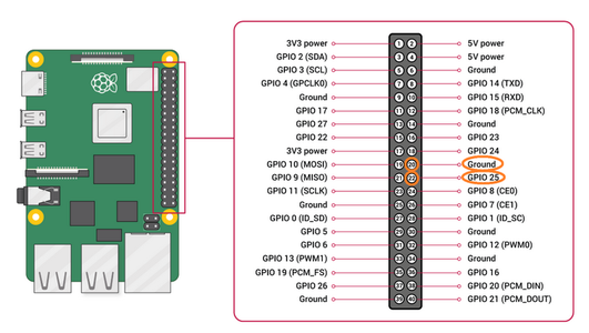

Step 9: LED
Connect the following pins to the LED using a 4.7k resistor on one of the pins to lower the current and ensure the LED doesnt shine like a laser pointed at your ayes ;)
LED Anode ➔GPIO 25 , pin 22
LED Catode ➔GND, pin 20
