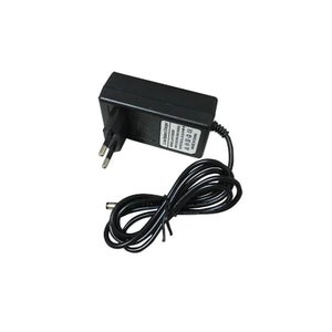

  6. 1 x 5V 4A power supply

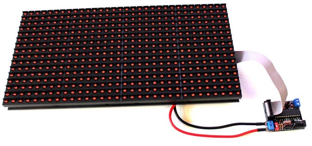

Step 1: PREPARE THE SCOREBOARD UNIT
You will see arrows at the back of the display: 1 or 2 pointing upward and 1 or 2 pointing to your right. Place the display on your table exactly as shown in the image.

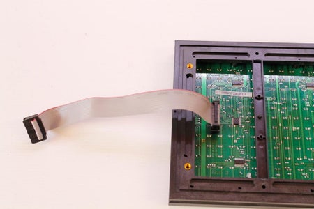

  1. Connect the 16-pin IDC cable to the LEFT IDC socket.

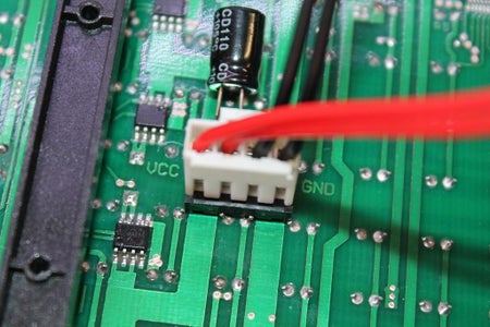

  2. Connect the power cable to the VCC and GND terminals on the display board. The RED wire goes to the VCC pin, and the BLACK wire goes to the GND pin.

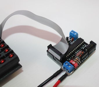

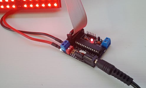

Step 2: CONNECT THE SCOREBOARD UNIT TO THE SCOREDUINO-DMD Module

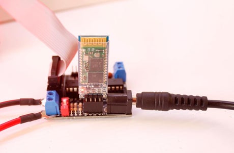

  • Use a screwdriver to connect the power cable to the screw terminal of the SCOREDUINO-DMD module.
  • Plug the IDC cable into the IDC socket on the SCOREDUINO-DMD board.

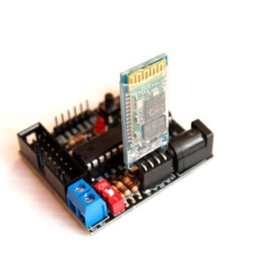

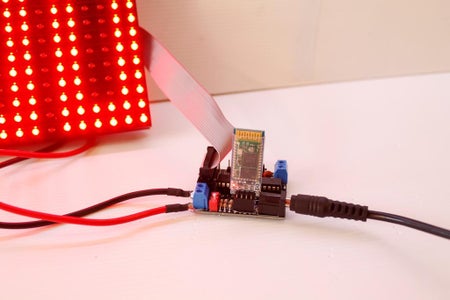

  • Attach the HC-06 Bluetooth module to the SCOREDUINO-DMD board.

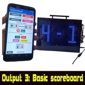

Step 4: Operate Using Scoreduino App

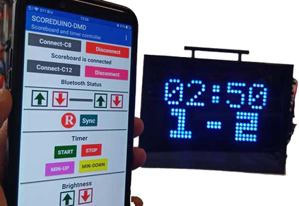

To operate the scoreboard, follow these steps:
  1. Download the app. This app is for controlling your scoreboard. There are more than 20 apps built for different scoreboards. Users will be given a link to the correct app to operate the scoreboard of their choice.
  2. Go to your phone's settings and pair your phone's Bluetooth with the scoreboard's Bluetooth.
  3. Open the app and navigate to SCORE4 Basic.
  4. Connect your phone to the scoreboard's Bluetooth through the app.
  5. You can now operate the scoreboard. When you send commands, the scores will increase or decrease accordingly.
