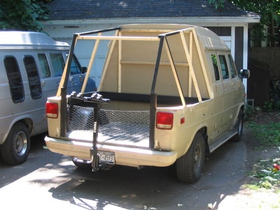

Step 2: Some Background...
Here was the original inspiration for the 2x2 method. Mega Van.
I built this machine to roam the country one year. This was the inital pic.
