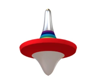

Top: You can use a pre-made top or make your own from scratch.

3. Moment of Inertia: The top’s ability to spin is also influenced by its moment of inertia. A top with weight concentrated at its edges (like a heavy ring or wider rim) will spin longer and more stably.
