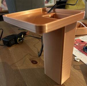

Step 1: Design and Print the Body
If you want to start from scratch, you need to :
  1. Use CAD software like Fusion 360 or TinkerCAD to design the machine's body.
  2. Include slots for the pumps, Arduino, button, and tubing.
  3. Design mounting points for secure placement of electronics and reservoirs.
  4. Export the design files and 3D print the body components.
  5. For any flat panels or decorative elements, use a laser cutter to cut acrylic sheets based on your design.
You can also use my designs on GitHub :
  1. box_bottom.stl
  2. box_middle.stl
  3. box_pipe.stl
  4. box_top.stl
  5. box_top_trou.stl
In that case just you have to download the files, slice them with Cura, and load the gcode files on your 3d printer.

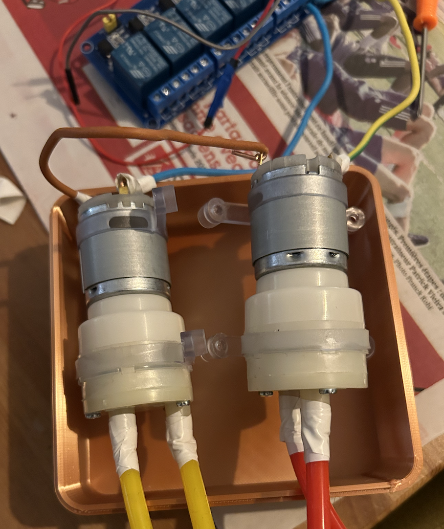

  1. Connect the pumps to the Arduino via the relay module.
  2. One pump will handle water.
  3. The second pump will handle syrup.
  4. Wire the push button to an input pin on the Arduino.
  5. Program the button to cycle through syrup strength levels (e.g., low, medium, high).
  6. Power the pumps using the 12V power supply.
  7. (Optional) Design a custom PCB to neatly organize the connections.

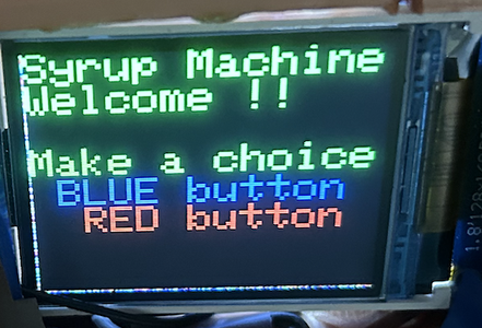

Step 3: Programming the ESP32
Steps to follow :
  1. Download the Arduino Code from GitHub : file CocktailMachine.ino.
  2. Use the Arduino software to compile and upload the code to the ESP32 board.
Many documentation on internet explain how to use the Arduino software.

void initTFT() {
// background
tft.fillScreen(TFT_BLACK);
// test header
tft.setCursor(0, 0);
tft.setTextSize(2);
tft.setTextColor(TFT_GREEN, TFT_BLACK);
tft.println("Syrup Machine");
tft.println("Welcome !!");
tft.println("");
tft.println("Make a choice");
// text body
tft.setTextColor(TFT_RED, TFT_BLACK);
tft.println(" BLUE button");
tft.setTextColor(TFT_BLUE, TFT_BLACK);
tft.println(" RED button");

  1. Install the pumps, Arduino, and button into the 3D-printed body.
  2. Connect the tubing from the reservoirs to the pumps and then to the output spout.
  3. Secure all components using screws or adhesive as necessary.
  4. Test for leaks and ensure all connections are tight.
