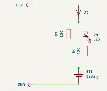

This easy-to-make circuit consists of just a diode, two 120-ohm resistors, and an LED.
It uses a trickle charge method, which provides slow and continuous charging while keeping the current very low to prevent overcharging the batteries.
Warning: Never use this circuit with lithium-ion or lithium-polymer batteries, as it can be dangerous.
This charger is specifically designed for 1.5V NiMH (Nickel-Metal Hydride) and NiCd (Nickel-Cadmium) batteries.
How It Works
The diode blocks passive discharge from the battery back into the circuit.
One 120-ohm resistor ensures proper LED operation.
The second 120-ohm resistor limits the charging current to safe levels.
Using a 5V power supply, and applying Ohm’s Law, the circuit delivers a maximum charging current of approximately 40mA.
While this means the charging process is very slow (requiring several hours or even days), it ensures optimal safety and extends the lifespan of your NiMH and NiCd batteries.
This method is ideal for hobbyists and DIY enthusiasts looking for an affordable and reliable way to recharge AA or AAA rechargeable batteries.
