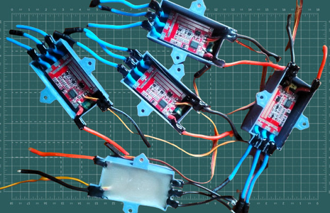

Step 2: Thrusters and ESCs
For ROV2, I used 3D-printed, modified BlueRobotics T100 thrusters, which are a cost-effective choice. These thrusters use $5 A2212/13T 1000KV Brushless Outrunner Motors. Since these motors have no contact with the inner coil, they can be used underwater without causing any damage. However, it's important to dry the motors after using them in fresh water. If they've been used in salty water, you need to rinse them with fresh water and then dry them thoroughly. This maintenance ensures the longevity and performance of the thrusters. Each thruster provides approximately 1.26kg of thrust at 12V, 10A.
However, the electronic speed controllers (ESCs) need to be waterproofed as they are not designed for underwater use. I have 3D printed a case to house the ESCs and waterproofed it with epoxy resin. Each thruster requires a separate ESC.
Currently, I'm using reverse thrust only for the vertical thrusters. To reverse the thrust direction, you simply swap any two wires coming from the ESC. There are bidirectional ESCs available on the market but I have used a normal ESC and a relay to swap the two connections.
To mount the horizontal thrusters at a 45-degree angle, I have 3D printed a bracket. This bracket can be easily mounted onto the side panels using M3 screws. I've also placed a small piece of rubber between the bracket and the side panel to reduce vibrations made from the thruster.
All the CAD files for these components are available for download below.

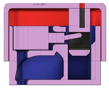

1. Prepare the 3D-printed Cases:
  • 3D print the cases for the ESCs according to the provided design. Ensure that the cases are appropriately sized to fit the ESCs snugly.
2. Insert the ESCs:
  • Place each ESC inside its respective 3D-printed case. Make sure that the ESC fits securely within the case.
3. Seal the Cases:
  • Apply a thin layer of epoxy resin inside the case where the ESC will sit. This layer helps create a waterproof seal.
  • Place the ESC in the case, ensuring it is centred and does not obstruct the case’s sealing surface.
4. Allow Curing:
  • Let the epoxy resin cure fully according to the manufacturer’s instructions. This usually takes several hours to overnight.
5. Test the Seal:
  • After curing, inspect the case to ensure that all edges are properly sealed and that there are no gaps or leaks.

Step 9: KILL Switch
As mentioned earlier, I'm planning to upgrade this ROV into an autonomous underwater vehicle (AUV). AUVs are designed to operate independently without direct human control, which is why having an emergency stop mechanism is vital. An emergency stop switch, also known as a kill switch, becomes crucial in preventing potential damage or hazardous situations if the system encounters any malfunction or unexpected behaviour. This feature provides a reliable fail-safe option to immediately halt all operations, ensuring safety and preserving the integrity of the equipment.
To achieve this, I’ve designed a waterproof switch that allows you to stop the vehicle at any time. This kill switch design is specifically tailored to be easy to access and activate, even in underwater conditions. The switch assembly consists of a toggle switch housed in a waterproof casing, ensuring it remains functional and reliable in wet environments. Below are the steps to create and install the kill switch for your ROV.
  • Download the CAD file for the waterproof switch case (file provided below).
  • 3D print the components: the lower case and the upper case.
  • Place a toggle switch in the designated position within the lower printed case.
  • Apply epoxy around the toggle switch to waterproof it.
  • Close the case with the upper case and secure it using a 5mm M3 screw.

Step 12: Failures
One significant failure I encountered during the construction of ROV V2 involved burning several Electronic Speed Controllers (ESCs) due to incorrect wiring. The design included a two-way relay system to reverse the direction of the vertical thrusters. However, I made a critical error by connecting the output wires from the ESCs to the positions intended for the motor wires on the relay. This configuration wasn't problematic when only one relay was activated, as it simply allowed the thrusters to run in one direction.
The issue arose when both relays were either simultaneously activated or deactivated. In this scenario, the wiring setup caused a short circuit because the ESC outputs, which are not meant to be directly connected to each other, were mistakenly shorted. This short circuit wasn't noticeable at low PWM values, where the electrical current was not high enough to cause immediate damage. However, when higher PWM values were used, which increased the current flow, the ESCs overheated and eventually burned out, leading to a failure in the ROV's control system.
Seeing smoke emerging from the enclosure was devastating, especially after carefully assembling the entire system. This incident was a harsh reminder of the importance of verifying every connection and thoroughly understanding the wiring before applying full power. Such mistakes can easily lead to the destruction of electronic components, resulting in delays. To prevent similar issues, it is crucial to double-check all wiring and connections meticulously.
