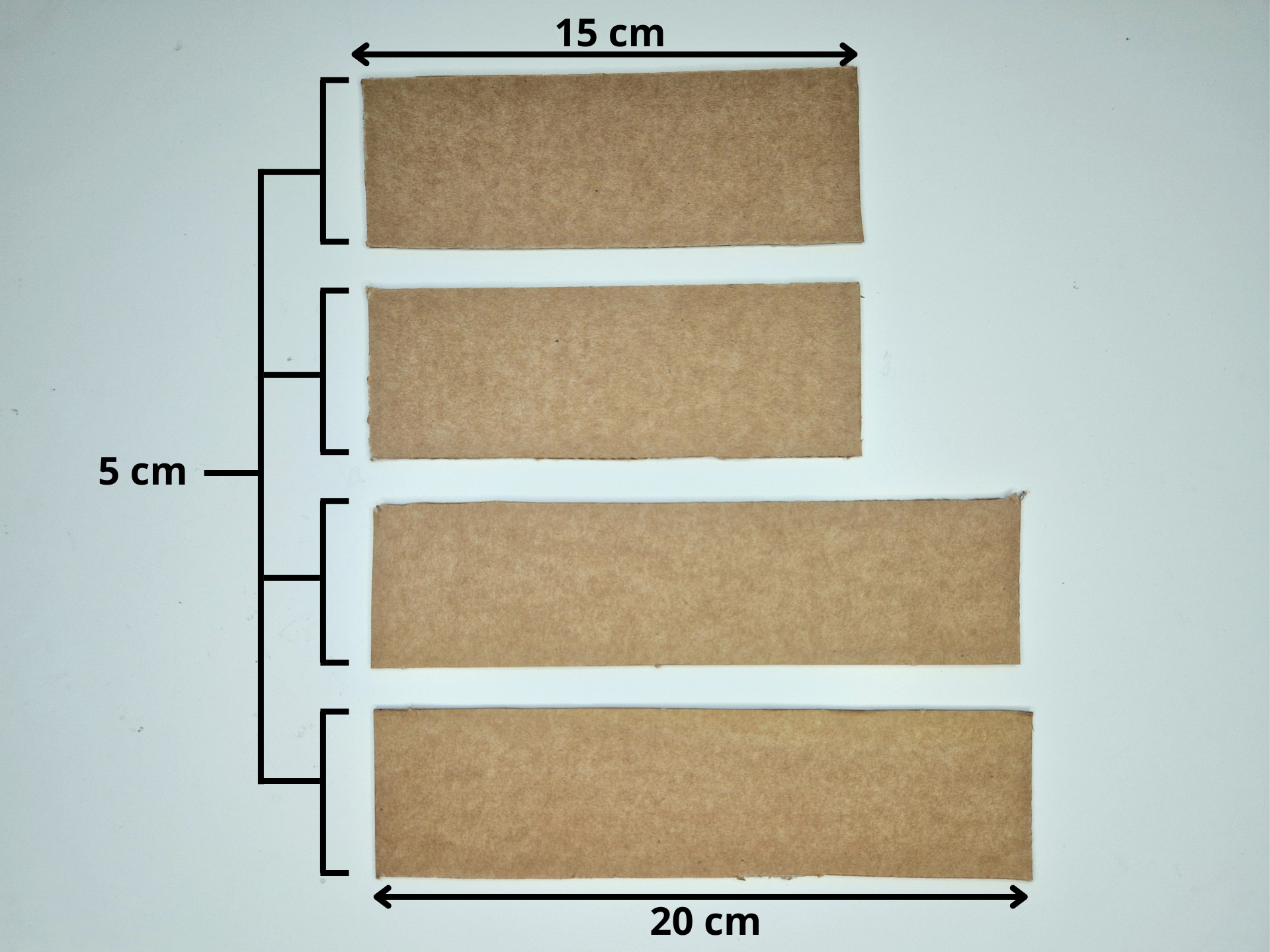

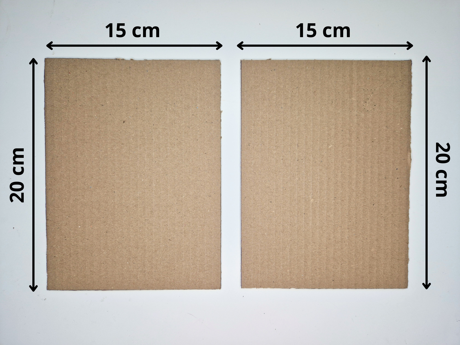

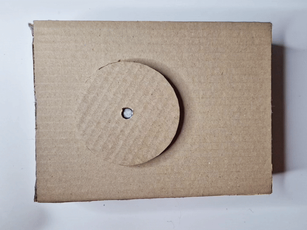

Making the Top and Bottom Pieces
Grab a piece of cardboard and cut out two rectangles measuring 15x20 cm each. These will serve as the top and bottom of the case.

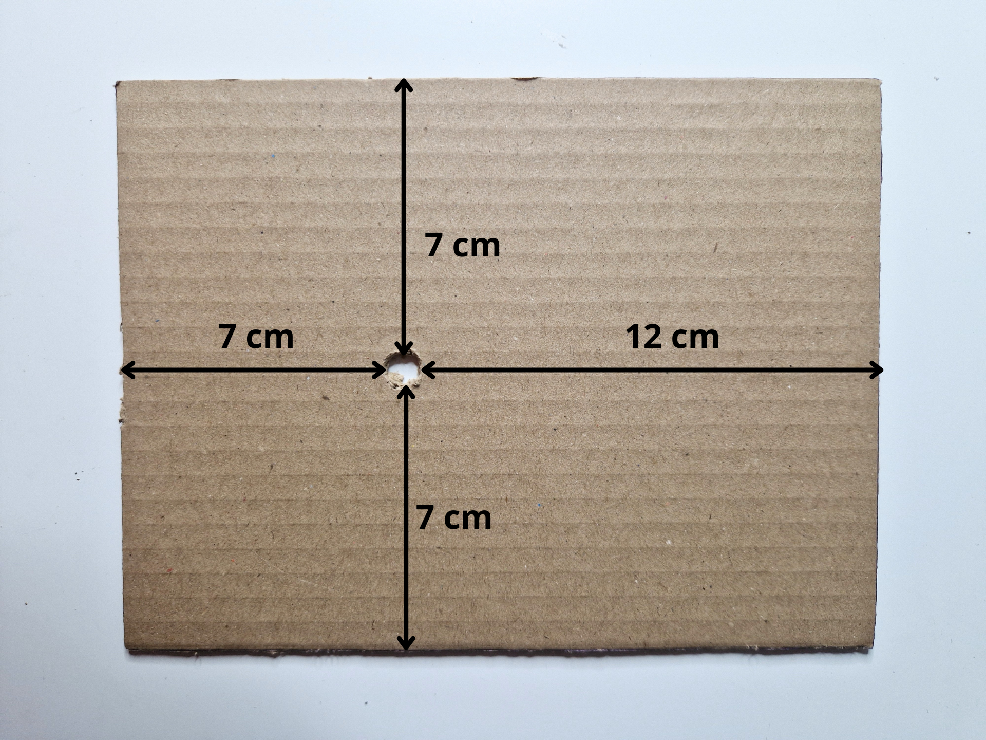

On the top piece, create a hole of 1 cm in diameter. This hole is intended for the stepper motor.

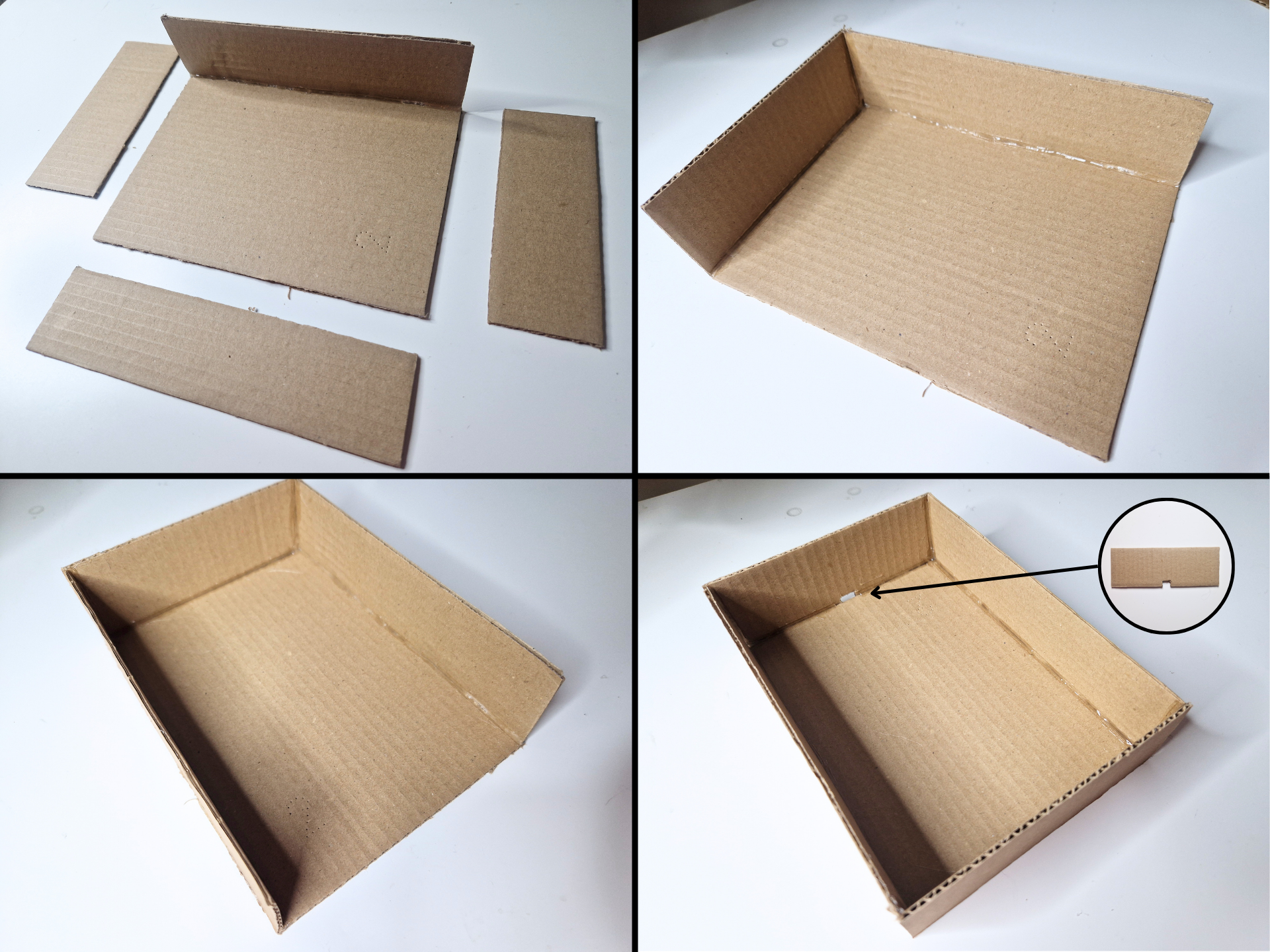

Making the Side Pieces
- Cut out two pieces measuring 15x5 cm.
- Cut out two pieces measuring 20x5 cm. These 4 pieces will form the sides of the case.
Cut a small notch in one of the 15x5 cm side pieces. This is where the USB-C port will be located.
Assembling the Box
Use a hot glue gun and glue all the pieces together to form a rectangular box. Keep the top open and make sure the edges are aligned properly.
Once all the pieces are glued together, you'll have a sturdy base for the record player.

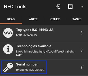

Step 2: Retrieving the UIDs of the NFC Tags
Before diving into the programming, you'll need to retrieve the Unique IDs (UIDs) from your NFC tags using an NFC-compatible smartphone and an NFC reader app. Each tag will allow you to play a different song on your record player.
Installing an NFC reader App
Ensure your smartphone supports NFC (Near Field Communication) and download an app that allows you to read NFC tags with your smartphone. For this guide, we'll use NFC Tools.
Reading the NFC Tags
- Go to your smartphone’s settings and enable NFC.
- Open the NFC Tools app and hold your smartphone close to an NFC tag.
- Look for the UID, typically labeled as "Serial Number". It will appear in a format like 04:AB:76:BD:79:00:00
- Note down the UID values of all NFC tags you want to use with your record player. Each tag’s UID will correspond to a different song.
Once you've noted all UIDs you wish to use, we can finally start programming the ESP32!

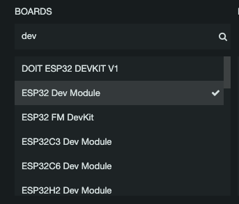

- Go to Tools > Board and select ESP32 Dev Module from the list of available boards.

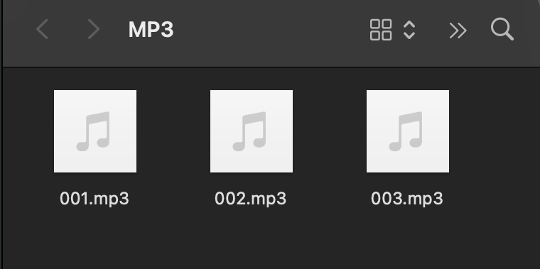

Step 4: Downloading Your Favorite Songs Onto the SD Card.
It's time to get your favorite songs loaded onto the SD card for use with the DFPlayer Mini module.
- Plug the SD card into your computer and create a new folder named MP3 on the SD card. Copy all your songs in MP3 format to this folder.
- Rename each MP3 file using the following format. For example:
- 001.mp3 for the first song.
- 002.mp3 for the second song, 003.mp3, 004.mp3, etc.
Each MP3 file corresponds to a specific NFC tag UID that you have programmed into your ESP32 code.
Make sure that the numbering of your MP3 files matches the order and UIDs of the NFC tags listed in the code. For example, if targetUID1 corresponds to the first NFC tag, then 001.mp3 should be the song you want to play when that NFC tag is detected.
Finally insert the SD card into the DFPlayer Mini module.

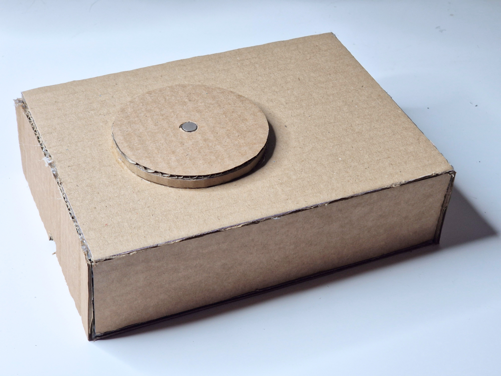

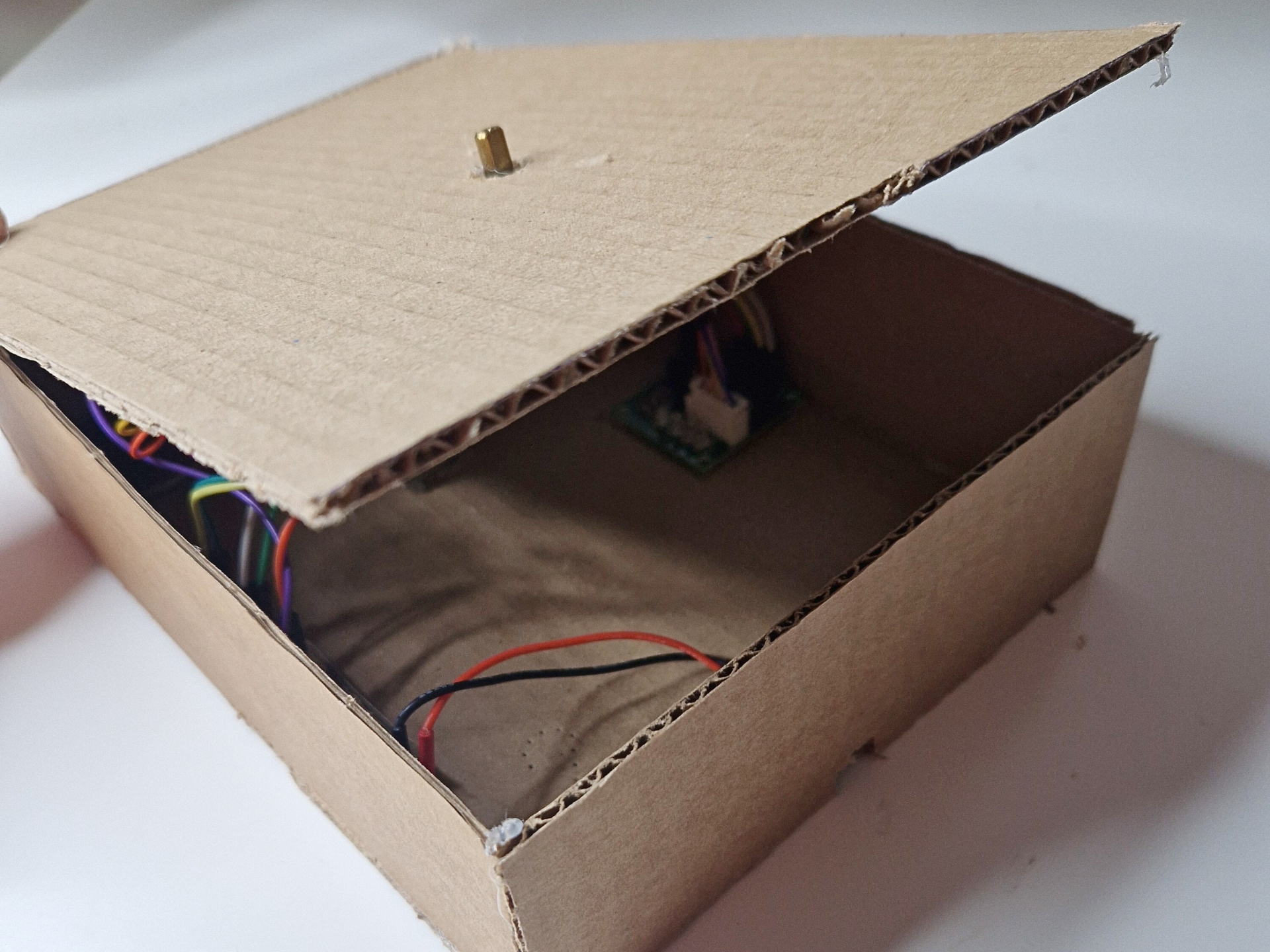

Step 6: Assembling All in the Case
Now that all the parts are ready, let's put everything together.
Attach Components to the Base:

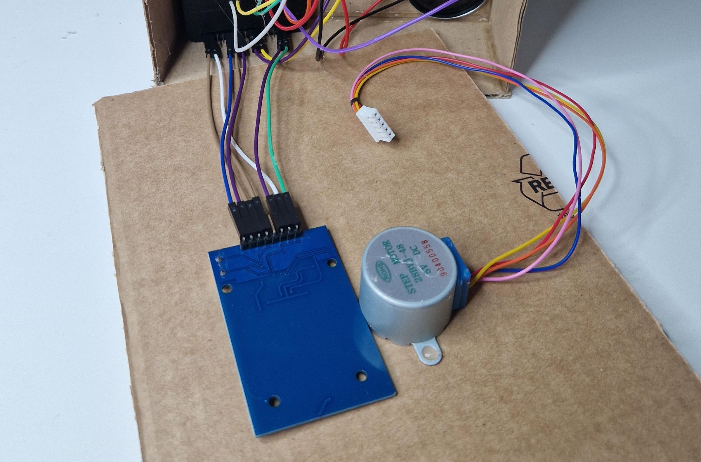

- Use hot glue to secure the ESP32, DFPlayer Mini, speaker, stepper driver board, and breadboard onto the base piece of cardboard.
- Don't glue the RFID module and stepper motor yet. These will be attached to the top piece.
Attaching Components to the Top piece:

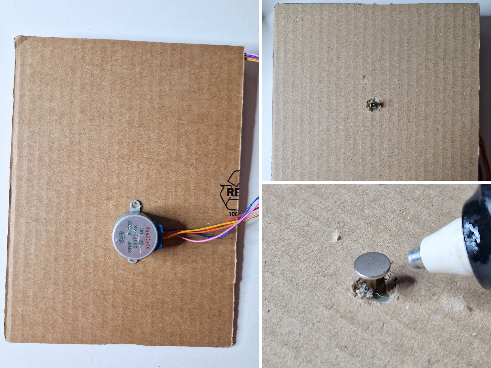

- Take the top piece of cardboard and fit the stepper motor through the hole you made earlier. Use hot glue to secure it in place.
- Attach a small magnet on top of the stepper motor rotor. This will hold your record disks in place magnetically.
Position the RFID reader module next to the stepper motor on the top piece. Secure it again with hot glue.
Double-Check Wiring:
- Recheck all the connections to make sure they are secure and correctly aligned with the specified pins.
- Power it up and test the setup by holding an NFC tag over the RFID reader to see if the stepper motor spins and the speaker plays music.
If everything is working correctly, carefully close up the box and secure the top piece to the base with hot glue.

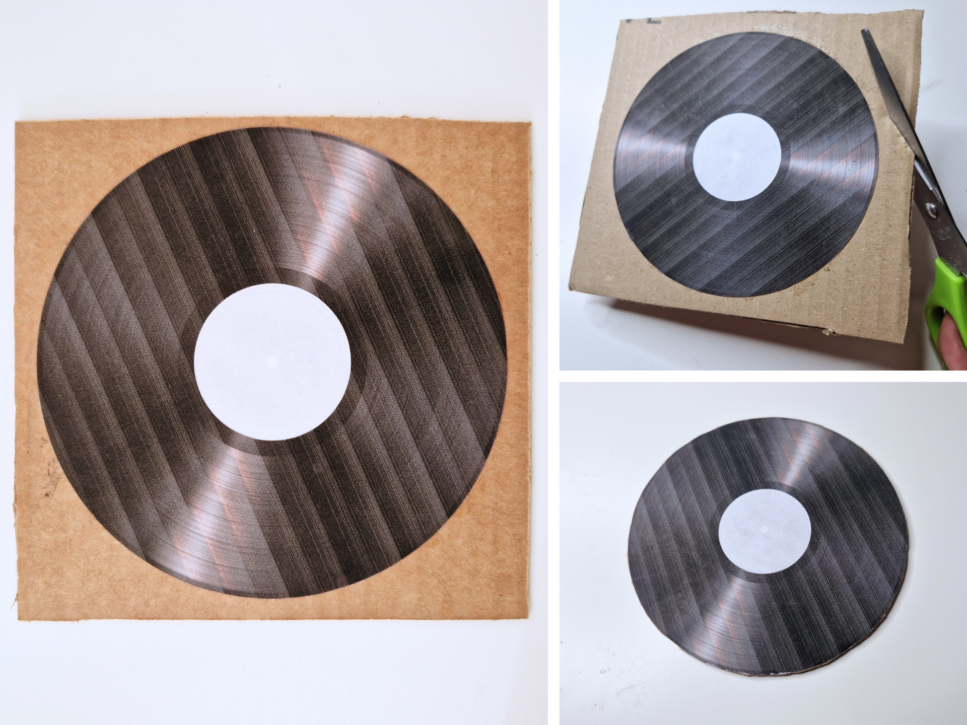

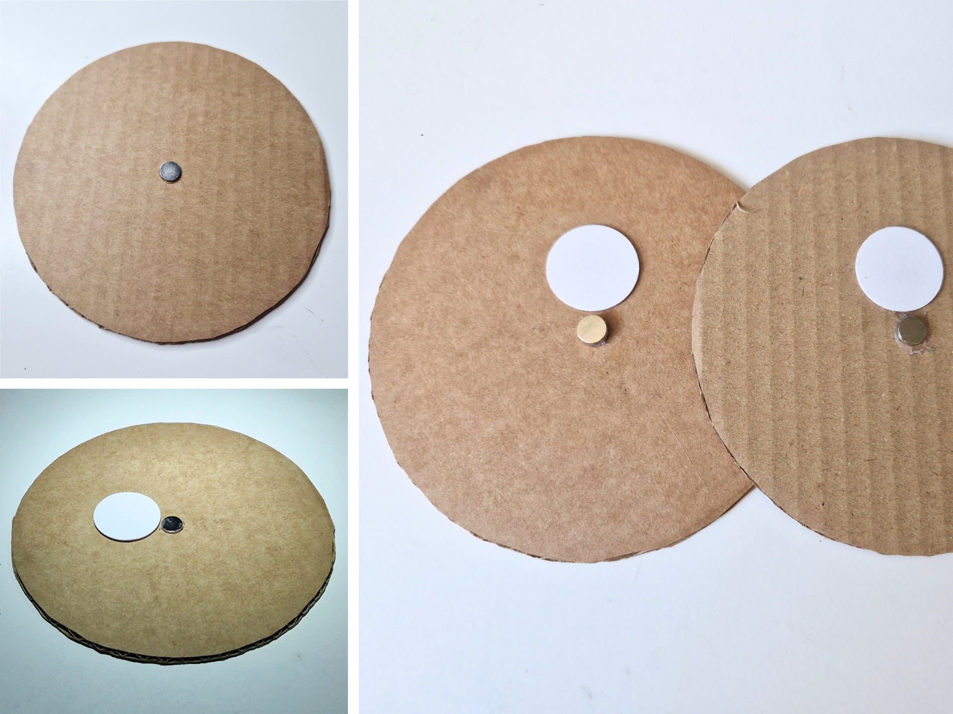

Step 7: Creating the Cardboard Record Disks
Let's begin crafting the cardboard "vinyl" disks.

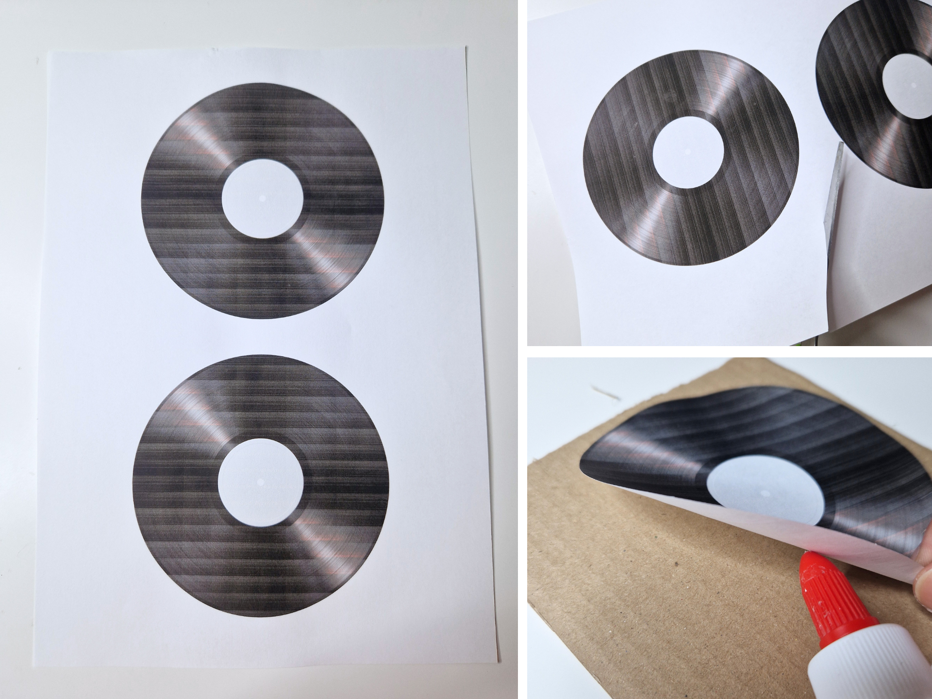

Start by printing out the provided PDF template on A4 paper, then cut out the templates. Glue these cut-outs onto pieces of cardboard.
Cut the cardboard along the edges of the templates to create your vinyl disks.
Glue one or two small magnets onto the bottom center of each disk. Remove the adhesive backing from the NFC tag and paste it right next to the magnets on each disk.
You can repeat this process and create as many disks as you would like.

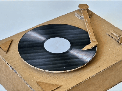

Step 8: Decorating & Adding Details

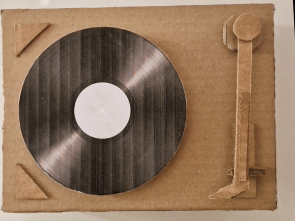

In this step, we'll focus on two main tasks: crafting the platform where the disks will rest and constructing the arm holder and the arm of the record player. Additionally, we'll add some cool details like a volume slider and other small cardboard decorations to enhance the look. Feel free to customize these decorations as much as you like. Let your creativity shine and make your record player truly unique!

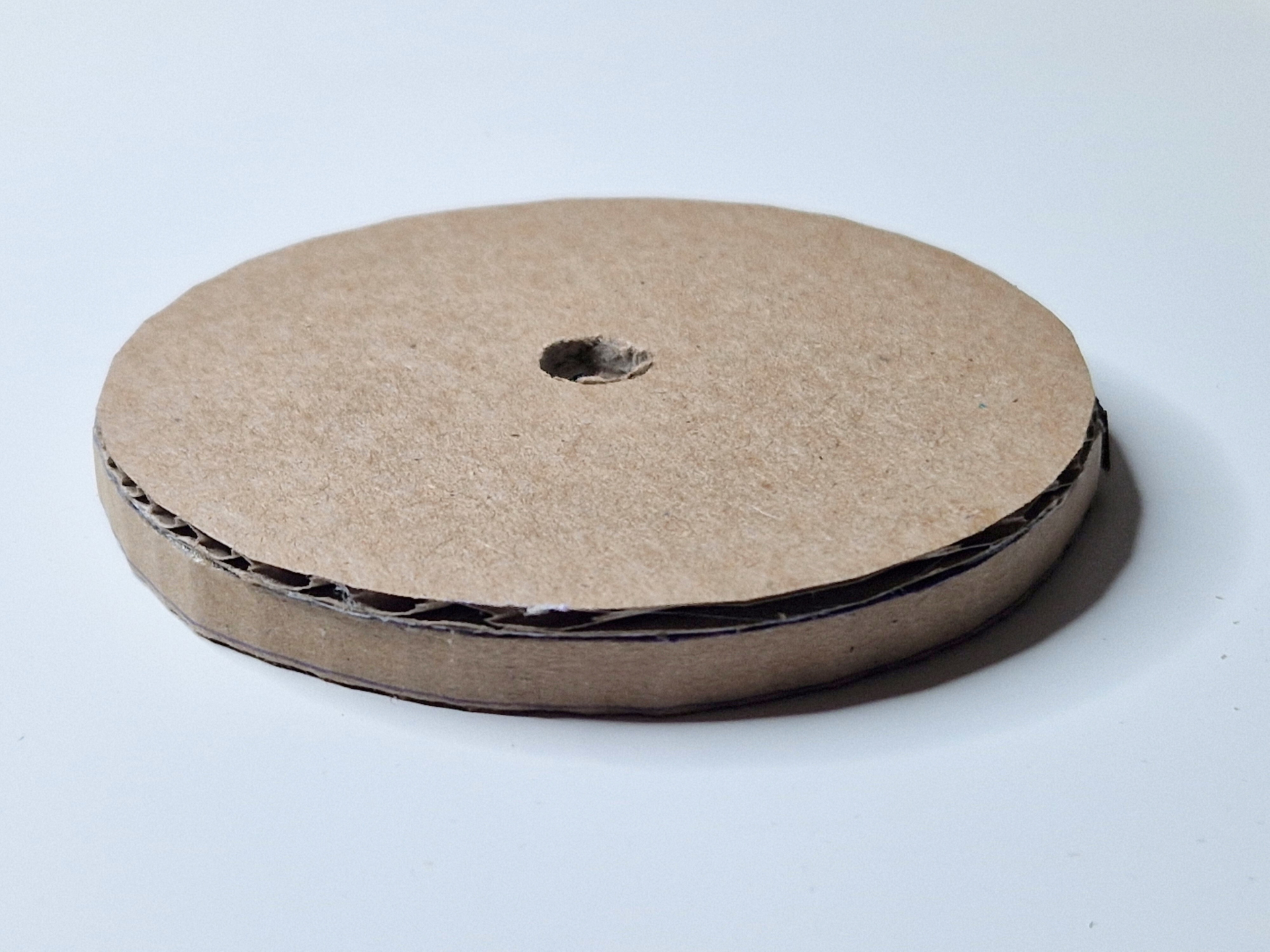

Crafting the Disk Platform
- Cut out a cardboard disk with a diameter of 8.5 cm. Make a 1 cm diameter hole in the center.
- Cut a strip of cardboard measuring 26.75 cm x 0.3 cm.
Glue the strip around the edge of the disk to create the platform.
Attach the platform to the record player. Make sure the center aligns with the stepper motor. The magnet of the stepper motor should be flush with the surface for smooth operation. If needed, add additional magnets to achieve a flush alignment.

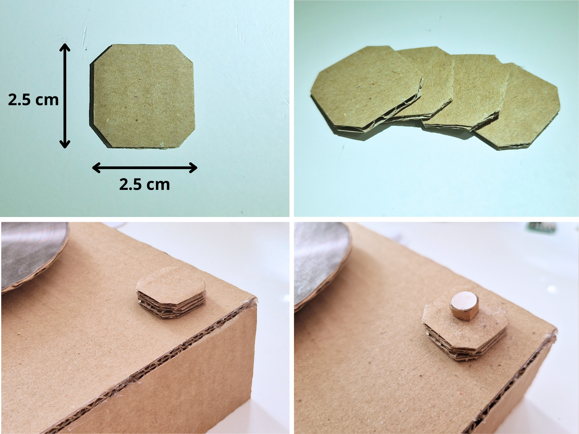

Creating the Arm Holder
- Cut out four small cardboard squares, each measuring 2.5 cm. Stack and glue these squares together, then position and glue the stack at the top right corner of the record player.
- Create an 8 mm diameter, 4 mm high cylinder from cardboard and glue it on top of the stack. Attach a magnet to the top of the cylinder. This will serve as the attachment point for the record player arm.

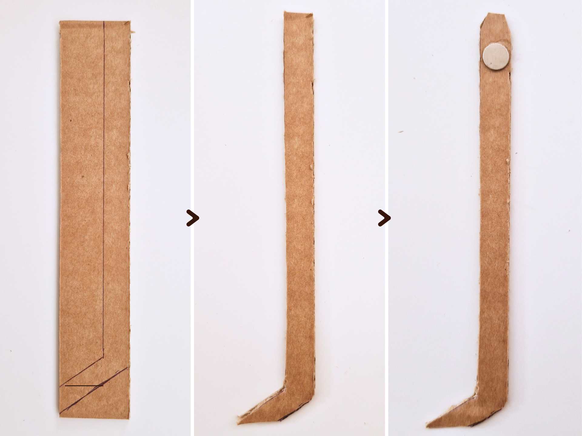

Creating the Arm
- Cut out a small rectangle of cardboard measuring 14.5 cm x 2.5 cm.
- Draw a "J" shape on the cardboard and cut it out to form the record player arm.
- Glue a magnet to the arm
- Bend the tip of the arm downwards slightly to ensure it makes proper contact with the disks during operation.
The arm magnetically attaches to the base and should move freely. Ensure the tip makes proper contact with the disk so it is able to move towards the center, just like a real record player would.

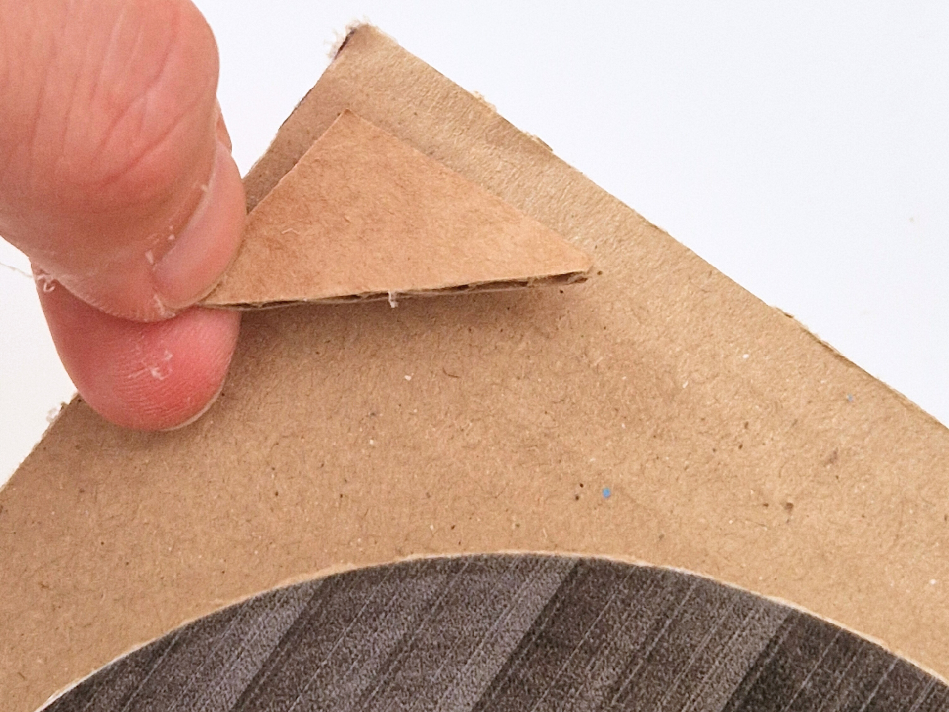

Adding the Final Touches

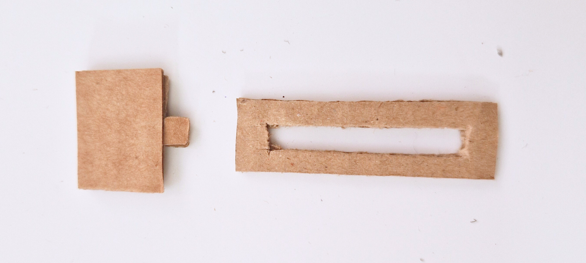

We're almost done! The last part is to create the volume slider and add some other aesthetic features.
For the volume slider, cut out two rectangles as shown in the image below and glue them to the bottom right of the record player.
I've personally added some corners to make it really stand out! You can also add your own personal touches in this step.
Step 9: Enjoy Your Record Player
