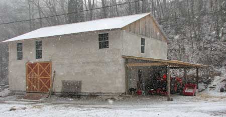

Introduction: Build Your Own Workshop Part 2 - Lime Plaster
This Instructable shows how to work with hydraulic lime plaster on a strawbale building.
Lime Plaster refers to a mortar using only pure lime as a binder and sand as an aggregate.
Lime has a long history of use, serving both functional and decorative purposes.
This is what I'm using as a exterior stucco and interior plaster on this project. I use the St Astier Natural Hydraulic lime and I'm very happy with the result. This is a very old building method, in fact Saint-Astier Natural Hydraulic Lime was used to build the city of Perigueux in France in 30 B.C. I purchased it from PA Limeworks in Allentown, PA.
I used Hydraulic lime plaster because it is one of the "greenest" materials you can use in construction. This is due to its purity, its calcium carbonate composition, it's CO2 absorption, its longevity and potential for allowing the materials to be reused or recycled, and the result of a low energy production process.
Below are some key advantages to using Natural hydraulic lime as a stucco on strawbale .
Elasticity-Important in minimizing shrinkage and cracking.
Allows for minor movements.If the building moves, a lime mortar will move with the building. Through crystalline bridging, using the free lime content, the lime mortar will heal those cracks that occur. Portland cement can become brittle as a result of it's high burning temperatures
Permeability- Good vapor exchange qualities allow for condensation dispersion.
Allowing structures to breathe reduces or eliminates condensation and rot . Bugs don't like it either.
Hydraulic lime plaster will combine the ability to resist water penetration while allowing the structure to breathe freely
Self healing- small cracks will heal up because of the amount of free lime in the product.
If some cracking occurs in the brown or second coat, you can mist the crack and close it up the next day.
Insulation- The breath-ability of NHL mortars reduces moisture in walls, therefore improving insulation levels.
Reworking- All St Astier mortars can be reworked (8-24 hours), reducing wastage and increasing work rate. This is due to the absence of cement, gypsum, pozzolans or high aluminates.
Recycling- Materials built with hydraulic lime mortars can be reused. the NHL mortar itself may be recycled in a number of ways, such as an aggregate for new lime mortars, fertilizer (NHL is calcium carbonate), or it can be used for water purification to adjust pH levels.
CO2 absorption- The most eco-friendly feature of using limes. CO2 is reabsorbed during the carbonation of the free lime. Also the amount of energy used at the production stage is one half of what is needed to produce cement. Consequently, the release of CO2 into the atmosphere is much less.

Step 7: Finish Coat
Exterior Finish: Trowel apply an 3/16" thick finish coat by hand with 1 part
NHL 3.5 and 2-1/4 parts sharp, well-graded finer sand with the same mix and
cure conditions as the first coat.
Interior: Trowel apply an 1/8" thick finish coat by hand, (troweled smooth
and tight) with 1 part NHL 2 and 2 parts sharp, well-graded finer sand with
the same mix and cure conditions as the first coat adding no more than 8% of
the binders's weight of your own pigments.
