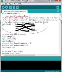

1-I use teleduino server u must request Key for you :
https://www.teleduino.org/tools/request-key
2-Download the library of teleduino ,,,
https://www.teleduino.org/downloads/
•If you don't know how to add a Library to Arduino IDE you can follow this guide: https://www.arduino.cc/en/Guide/Libraries
• upload the [teleduino ethernet 328 client proxy] - put your key of teleduino in the sketch,, Like picture above.
after install the librarry and adjust the code by the key ,
send me your Email and key to adjust the Apk file For you .
