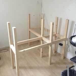

Step 3: Building the Framing
First step here was to cut all the bars to the length they had in the CAD-plan.
To build the framing we first built all the frames in "one direction" (also see the notes on the image) by connecting the horizontal and vertical bars with brackets from underneath and one tilted screw from above.
After the three frames in one direction where built, we connected them with the remaining horizontal bars.
