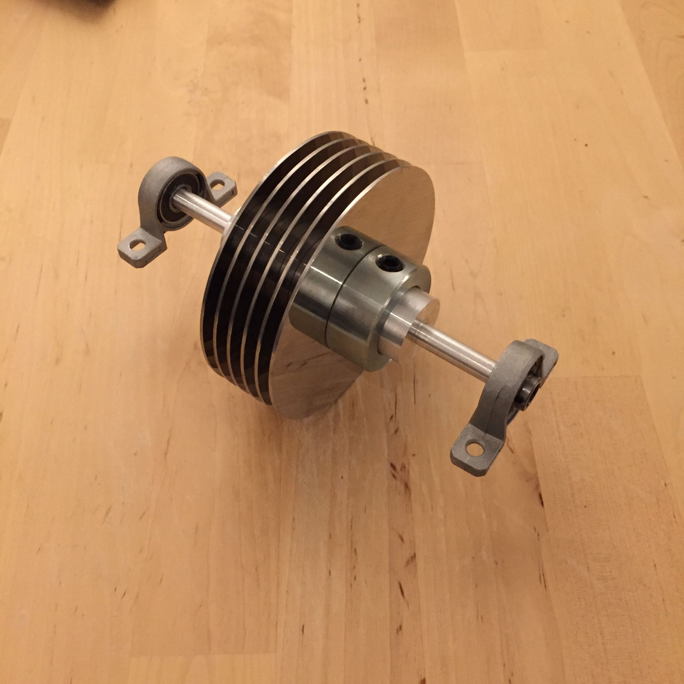

Step 3: Make the Shaft
This is just a piece of aluminum stock turned on a lathe. The center diameter is about .98" (which is the inside diameter of the platters) and about 1.77" long (so it will fit in a piece of 2" thick acrylic).
The thinner sections on each end are turned to fit the ball bearings I pulled from a box of scrap.
Step 4: Make Collars
The collars are made from more aluminum stock are wider versions of the platter spacers. The inside diameter is also .98" but they're about .3" thick to hold a #10-32 set screw.
Step 5: Rotor Assembly
Center the platters, spacers, and collars on the shaft and tighten the set screws to hold everything together. I used 11 platters, and 10 spacers. Try to line up all of the ventilation ports. If there isn't enough tension between the two collars, the platters can rotate around the shaft instead of with it.

How are the discs attached to the shaft? are they welded?
Reply 8 years ago on Introduction
same doubt can someone reply to my mail chilumulapraneeth93@gmail.com
This design uses collars that utilize screws to hold the disk together with friction. Tesla's design uses a keyed shaft. Another method is to use something like a dove tail and collars. This method is very simple and cheap.
Reply 5 years ago
If u use a tap and dy set then just thread the shaft and use very small, light ,thin nuts like wat is used with potentiometer on soundboards.
Reply 5 years ago
U can also just use a nut
