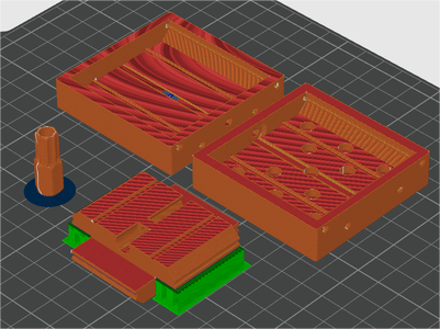

Step 3: Print the Parts
The 3D files for all three stages are freely available on the following websites. Take the time to read the description as various versions are available depending on the tolerances of your 3D printer and the type of hot melt insert you want to use.
X stage:
Makerworld, printable, thingiverse
XY stage:
Z stage:

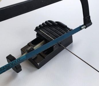

Step 4: Cut the Rods to Size
The first step to build these stages is to cut the rods to the right dimensions (X stage 4x 64.5mm, XY stage 8x 64.5mm, and Z stage 4x 25.5, 2x 44.5 and 2x 61.5mm). You may off course do that by hand if you wish but i designed some cutting guides to help you with the task. Just fix the guide in a vice, insert the rod to the end and cut at the extremity. To facilitate the insertion, i recommend making a chamfer at one of the rod's extremities by holding it in a drill and spinning the tip against a file.
