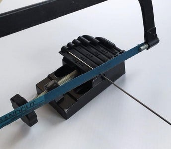

For this assembly, you will need 2mm rods cut into 4x 52.5mm segments, 4x 63.5mm segments and 3x 44.5mm segments. You can of course cut them by hand, or you can choose to print and use the cutting guide I designed. The one shown in the illustration offers 6 different lengths adapted for this project and to my 3D printed linear axis. You can choose to print the smaller version with only the relevant lengths for the micromanipulator.
To cut the wire, first grind the extremity flat with the file (factory rods are often cut with pliers, causing an uneven top surface) and insert it into the guide. Cut the wire at the adequate length and grind the second end.
To facilitate the insertion, I advise to add a chamfer at one end. To do that, fix the rod in the drill and spin the tip against the file.
