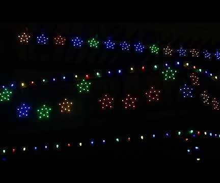

While working on a new 3D printer design on a hot day in mid summer my mind naturally wandered into thinking about Christmas house lighting. My father taught me, by example, that holiday lighting displays, hung about the exterior of ones home, could lift spirits in the cold start of winter weather. To this end (and because this was something most people did in 1950s suburbia) we strung a respectable amount of colored lights around the house's facade and into and through the bushes in front. I have always subscribed to this effort, whenever able, through my adult life.
In the past few years I have seen, on television and online, the proliferation of massive computer controlled Yule displays in the yards and on the houses of the (maybe not so) common homeowner. While I will assert that I do NOT suffer from "Lighting Display Envy", I have lately wanted to add a small version to my otherwise static holiday lighting. To this end, I researched pixel displays and how to implement them.
My concept started out as a small tree-shaped object welded using metal rods such as the ones used to hang suspended acoustic ceilings. I had seen a You-Tube video in which the rods were spot welded to metal hoops to make a tree-shaped frame with the lights secured to the vertical members. I said to myself "Self, you can do that". After procuring the needed materials: rod stock, metal hoops, welder and assorted supplies, I merrily set out to teach myself to spot weld so that I could complete the task. After some time, though, I said to myself "Self, you ignorant fool. You can't weld!". After many more attempts, though, I was able to "blob" things together and,as my friend later told me, "That's what grinders are for".
Although I will use these welded versions, it occurred to me that I have perfectly good 3D printers just waiting for something to do. After some preliminary design, I came to the conclusion that "This could work!". I designed and printed all the parts, cut and painted the rods and hoops and assembled my tree. With the addition of the pixel strips, an Arduino Uno, a power supply and programming from the Adafruit Neopixel library, I had a pretty nice looking/working tree.
Now as to the title of this Instructable; for the nitpickers it should probably be "Build a 3D Pixel Tree and Yes I Know the Metal Parts are Not 3d Printed But All the Other Parts Are)", or something similar.
