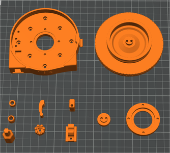

Step 2: Print the Parts
To build this stage you will need to print one of each of the following files: "RZ stage table", "RZ stage base", "M5 spacer", "M5 nut", "M5 knob", "Engagement insert", "Engagement handle", "Break handle", "Brake", "Bearing holder out" and "Bearing holder in". All files can be found here: makerworld, printable, thingiverse
Among those parts only the "RZ stage base" and "M5 knob" require supports. The "RZ stage table" also comports some fine geometries used to connect to the driving bolt. You may want to use a specially detailed printing profile with this part. In case those details are not correctly printed it may cause and increased wear on the part and a diminution of the force applied by the driving bolt on the stage (the stage will not rotate well when the knob is turned).
