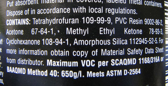

- the PVC glue contains nasty solvents - use it outdoors with the wind blowing away from you
- the PVC cutter is very safe for a cutting tool, but nonetheless it is sharp

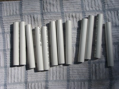

Step 3: Mark Your Cuts
If you lay your pipe down next to your ruler, it is easy to mark off the cuts.

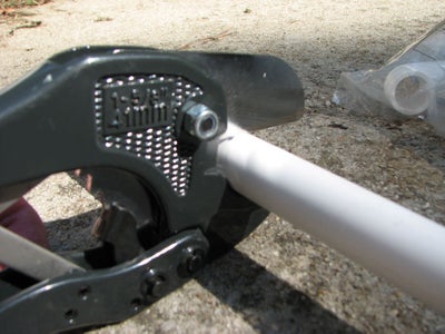

Step 4: Make Your Cuts
Here we see the pipe cutter about to make a cut. It helps that you cut the pipe while it is laying down. Otherwise it will bend as it is cut and you'll end up with slanted ends.

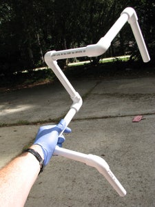

Step 7: Step 1
Attach an elbow to a segment, turn it upwards, then attach another segment pointing left.
Step 8: Step 2
Attach a segment facing away from you.

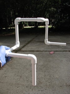

Step 9: Step 3
Attach a segment facing up.
Step 10: Step 4
Attach a segment facing right.
Step 11: Step 5
Attach a segment facing away.

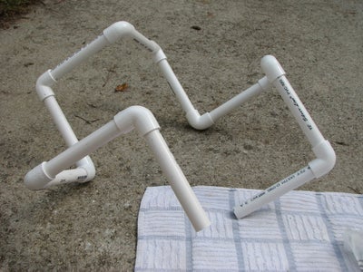

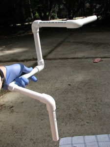

Step 12: Step 6
Attach a segment facing down. I provided two views so you can better verify you've got it correct so far.

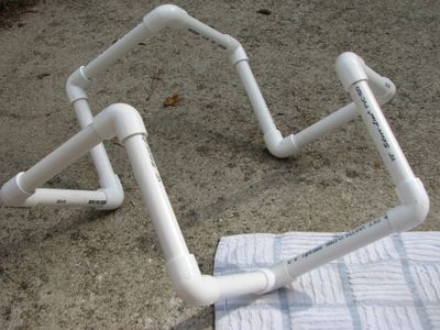

Step 16: Step 10
We're getting towards the end. It's easier now to lay the sculpture down on a clean surface. Attach a segment facing left.
Step 17: Steps 11 & 12
Here's the last one. I've combined the two steps here because we need one last piece coming towards you and are attaching to the piece going upwards.

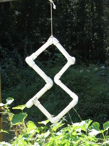

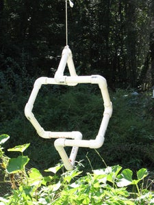

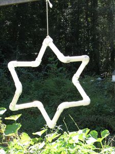

Step 18: Build Verification and Completion
You're done. Tie the sculpture up by a vertex and let it hang. Give it a spin, step back a bit, and if you're able to see a six-pointed star at some point your sculpture is a success.
