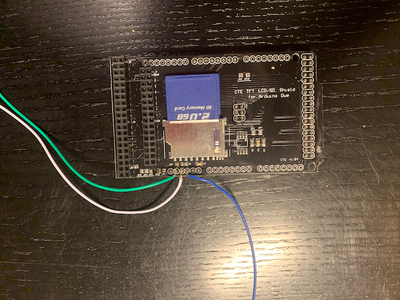

Step 1: Prepare the TFT Shield and the TFT
The TFT shield will cover the upper side of the Arduino completely. No additional wires can be connected easily. There are no prototype boards on the market that work with a shield. For this reason I soldered a few wires to the shield to get access to power after mounting the microcontroller to the shield.
The blue wire is GND, the white wire is +5V and the green wire is +3.3V. There wire can be connected to a breadboard at the base of the display to provide power for the keyboard and additional devices.
My DUE shield as an own SD card slot. An old 2 GB SD card formated with a FAT filesystem serves as mass storage. Best preload the BASIC programs from the repo to have them ready once your computer is up and running. There are games, test programs and demos of the Arduino functions in three different folders in the repo.

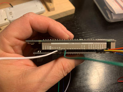

Turning around the shield you see an important detail; DUE shields have a SPI connector in the middle of board. Unlike the MEGA 256 the SPI bus of a DUE cannot be accessed from pins 50-53. It is only reachable through the middle SPI connector. A MEGA shield will not work on a DUE as mega shield often do not have the extra SPI pins in the middle of the board.
There is one more important point when you use the TFT shield for DUEs. In the library folder of UTFT (UTFT/hardware/arm) you need to edit HW_ARM_defines.h and uncomment #define CTE_DUE_SHIELD 1. If you use other shields consult the UTFT documentation.

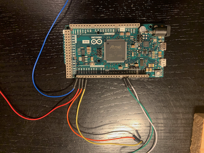

Step 2: Prepare the Arduino
I use pins 8 and 9 to connect the PS2 keyboard, the second serial port for the printer and the I2C pins for the optional real time clock and other peripherals. Later the pins for Serial1 on the DUE will also be connected for printer and modem support.
To get access to the pins without more soldering cables can be hooked up in the DUE before the shield is connected. Pressing the DUE on the shield will hold the cables in place. This is not perfect electronics but it works. Then plug DUE and shield to the backside of the display.

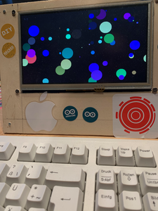

Enjoy a fully featured 64kB BASIC home computer with graphics.
The graphics output in the picture above is created by the program
10 CLS
15 I=0
20 X=RND (800)
30 Y=RND (480)
40 R0=RND (40)
42 R=RND (255):G=RND (255):B=RND (255)
43 COLOR R,G,B
50 FCIRCLE X,Y,R0
55 @X=1:@Y=1:PRINT #5;I;
56 I=I+1
60 DELAY 100
70 GOTO 20

A SD1936 TFT with an Arduino DUE plus the additional components is a slightly expensive projects. The display can cost 60 Euros nowadays and the DUE another 40 Euros. In total the hardware cost may be at around 120 Euros.
