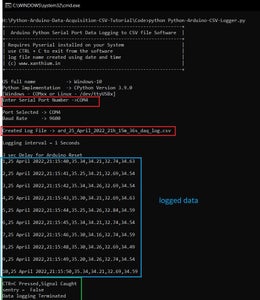

The Python data logger code connects to a given serial port and queries the connected Arduino for temperature values.
The Python code sends the character '$' to the Arduino.
The Arduino replies with 4 temperature values in the format Temp1-Temp2-Temp3-Temp4.
The Python code then reads these values from the serial port and writes to a CSV file.
User presses CTRL + C key combination which generates a SIGINT signal.  SIGINT signal is captured by the signal handler which in turn makes the sentry variable False, resulting in code exiting from the loop.

Step 6: Running the Python Data Logger Code on Windows
Make sure that you have Pyserial installed on your system.
If you are not familiar with Pyserial, Check our tutorial on using Pyserial
