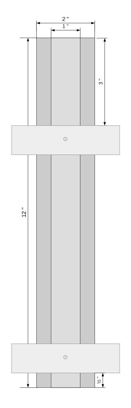

Step 2: Press Basket & Plunger Construction
There are many names for the parts used in cider presses, however I have come to refer to the slatted portion as the "Basket" and the pushing part as the "Plunger". These two pieces constitute the heart of the cider press and are used to contain and press apple pulp through the deck.
This step is the most time-consuming and complex part of the entire press. Take your time and try not to get frustrated!
Basic Cuts
Hardwood such as Maple or Oak are recommended. Cut ALL Length cuts inline with the grain for the highest strength.
Basket:
  • (16) 12 ” Length x 2 Width ” x ⅝ ” Depth
Plunger:
  • (1) 11 “ Length x 11 “ Width x 1 ¾ “ Depth
  • (1) 4 “ Length x 4 “ Width x 1 ¾ “ Depth
Note: If depth is unavailable, multiple layers may need to be glued and/or screwed together. This part needs to be very strong!
Order of Assembly
I’m going to break the assembly into sections. Depending on the tools you have, you may want to be cautious about what order you assemble the Plunger and Basket. The ideal is to get the plunger to fit tightly within the basket with a small amount of clearance for maneuverability (i.e. ⅛ “ on all sides), but this can be very tricky, depending on the tools at your disposal.
 If you have access to a lathe I recommend assembling the basket first, cutting the plunger to a slightly oversized circle, then gradually shaving it down to fit in the basket.
If you’re using a circle jig and can only get a rough size for the plunger, you should assemble your basket after you cut the circle for the plunger, then modify the slat spacing to fit around the plunger.
If you don’t have any of these things, you’re going to have to cut a 16-sided shape on your mitre saw. Take your time and be as precise as possible. There are pros and cons to this method but work with what you’ve got.
Basket
Once you have your basic cuts for the basket slats, you’ll need to set your table saw to a 7.5 degree angle and make the angle cuts as shown. If you’re not super comfortable with angles, make sure to watch some explainer videos on how to cut angles on the table saw and then make some practice pieces out of leftovers from the framing timber. Feel free to print off these design scale-models of the cut to check that you’ve got it right (make sure your print settings are set to accurate scale!).
Now that your slats are cut, it’s time to cut and drill the stainless strapping. When cutting your strapping the rule of thumb is to cut more than you need. In other words, treat the length measurement as a minimum. Cut two pieces of equal length and drill 16 holes at the provided spacing. You’ll notice that there is a length at the end labeled “Adjust for overlap”. Wait to drill these holes until after you’ve drilled the first 17. Since these holes will overlap, their spacing will end up slightly wider than the interior. While this could technically be calculated, it’s going to be more practical to drill the last three holes in place.
When mounting the straps, you will notice that our files suggest more spacing at the top than the bottom. This is to help account for the stress of pressing.
In order to do that, mount all of your slats except slats 1-3. Line up the 17th hole with hole #1 and mount that slat with the blank overlap on the outside. Next, use a vise-grip or other clamp to secure down the strap, and drill the final two holes from the inside out. It’s generally best practice to drill and mount one strap at a time to ensure maximum alignment.
Plunger
Once you have your large square piece cut out, it’s time to make it into a circle. A lathe is the ideal tool for this, but there are some explainer videos on YouTube about creating a circle jig for a jigsaw or router if you have that. Matching the plunger to the basket size is the trickiest part of the whole design. Take your time, always remember you can subtract more but you can never add more to the size of the plunger. If you get to a rough size that won’t quite fit, don’t be afraid to spend some time sanding it down to make it fit a little better!
Once you have your circle fitting within the basket, it’s time to prepare the top block. The dimensions given for the block are meant as a minimum size. Feel free to make the block a larger size as that will add even further support to the plunger. Just keep it within the diameter of the plunger itself. It is recommended that you pre-drill the holes for mounting the stabilizer, but it can be done afterwards as well. Attach the block to the center of the plunger base using 3” Stainless Screws. Next, mount the stabilizer to the block. The stabilizer might come with a securing bolt but you should remove it as it won’t be needed.
