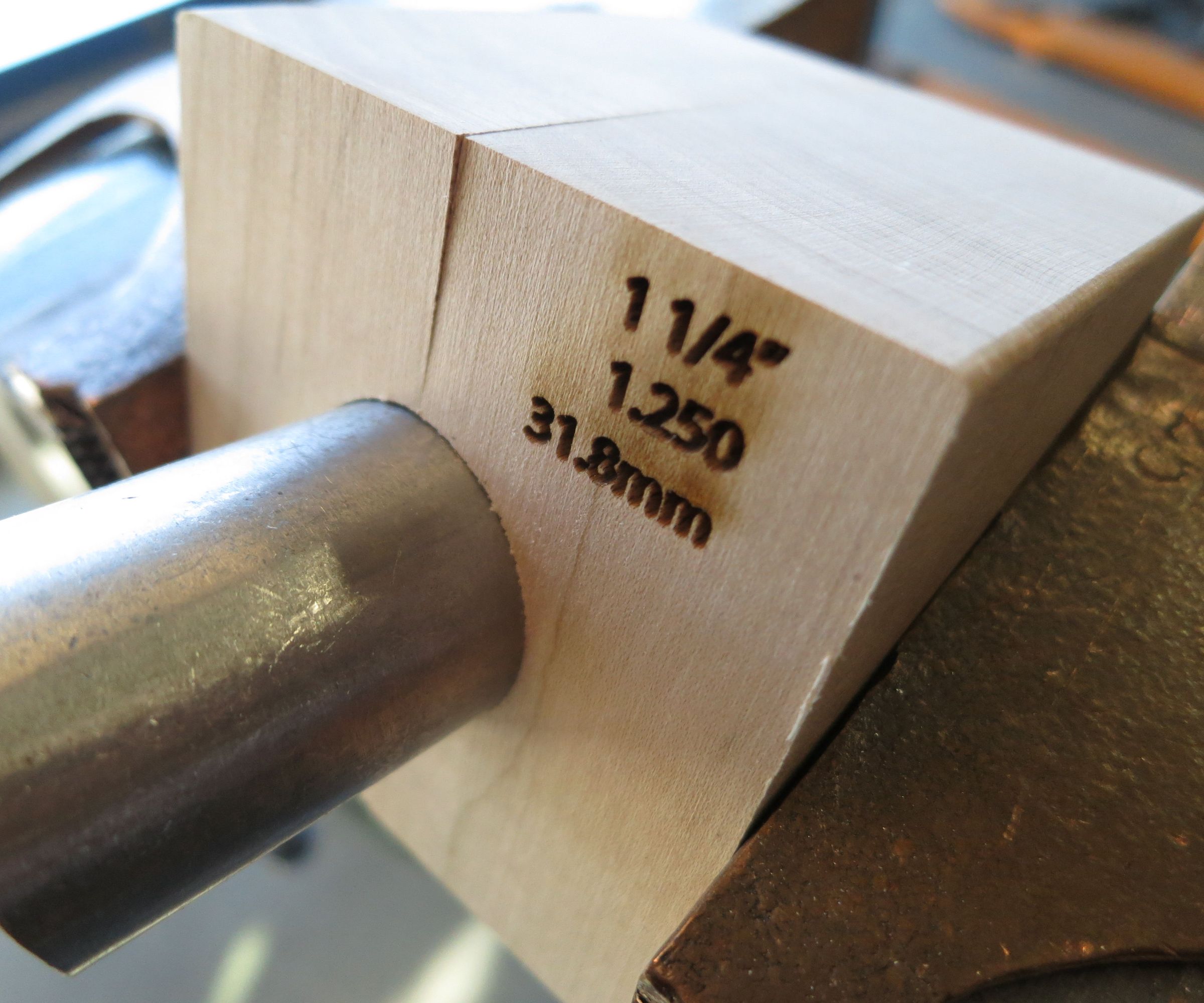

Step 3: Chain Stays
The first thing to do to the Chains stays is install the dropouts. Socket style dropouts simply slip over the ends of the stays while tab style dropouts require a little more work. I will go through installing tab style dropouts.
You need to make the tab on the dropout fit snugly inside the CS. To do this, measure the inside diameter of the CS and modify the dropout to fit. I made 6mm tabs of the CS internal diameter on my dropouts and 6mm deep slots the width of my dropouts in my CSs. The slots need to be angled slightly. This angle can come from you drawing. The two inner dropout faces will be parallel and a certain distance apart (likely 130mm as this is the standard for rear hub spacing). The CSs angle inward from the dropouts to the BB shell. Once you have the stays slotted and the dropouts tabbed it is time to braze them in. To make sure everything is aligned and accurate, it is best to use a fixture to hold the stays and dropouts while you braze. You really just need to make sure the angles are correct. I made a quick fixture that holds the stays the right distance apart where they will meet the BB. You want the chains stays to be at least 5mm inset from each side of the BB shell to allow room for your weld or fillet. The dropouts are held securely by a dummy axle from the UBI store. With the dropouts held parallel at the correct distance apart and the chain stays held the right distance part where they will meet the BB shell, you braze the dropouts in to the stays.
Once your stays look good, set them aside and get back to the front triangle.
