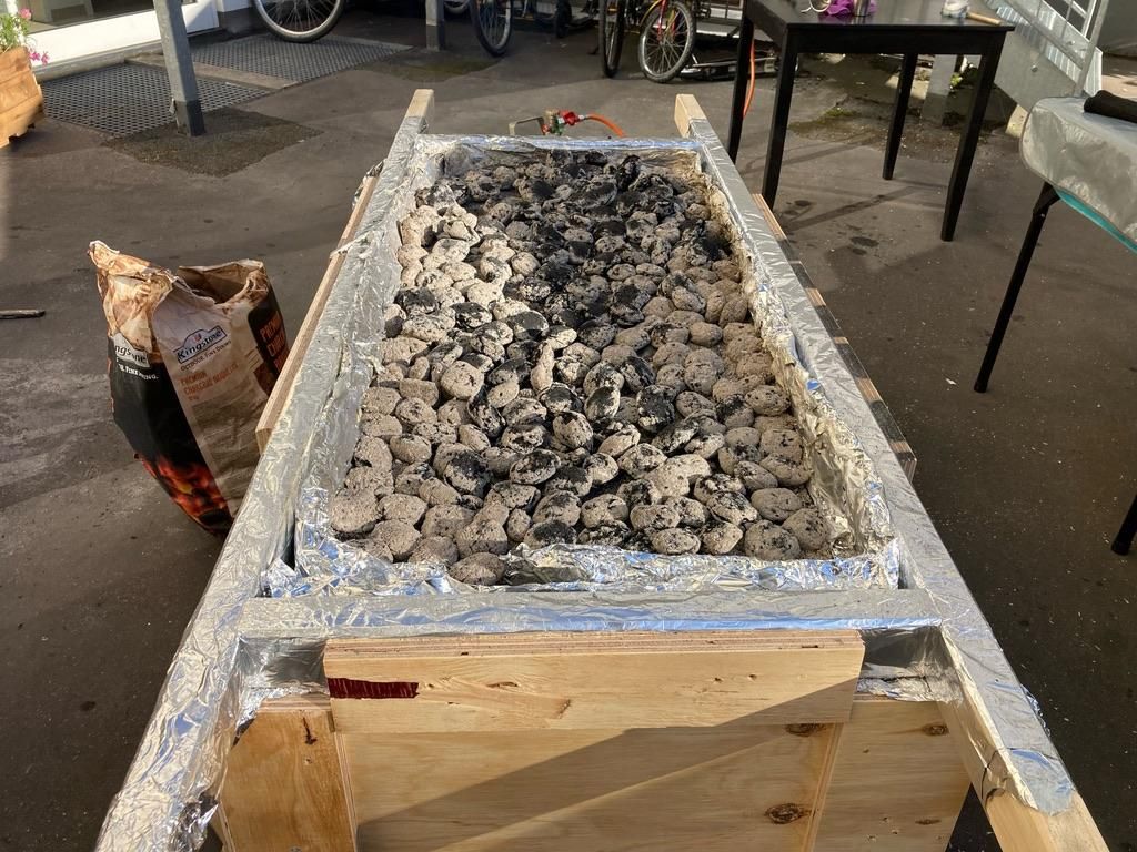

That completes the top frame. The steel area on top is where the charcoal burns (the charcoal tray).
And now you have your own Caja China! To make the box easier to pick up, attach some scrap wood blocks near the corners of the box.

Step 9: ROAST!
It should take about 4 hours to roast. Of course, that varies according to weather, temperature of the pig at the start, how many beers you drink... Use these instructions as a guideline.
Once the oven heats up, the general goal is to keep the oven temperature between 240-260° F. It should take about 3.5 hours for the pig to reach 185°F. If it gets too hot before that, you can lift the lid to vent some heat. If it's too cold, scoop out some ash and/or add more charcoal.
Why not just crank the heat way way up? Because collagen begins to break down into gelatin (which is what you want for fall-apart tenderness) at 160°F. But it's not just temperature-dependent -- it has to be held there for a certain amount of time to really soften up. If the oven temp is around 240-250°F, then once the pig reaches 185°F, it should have been in there long enough for the meat to be easily eaten by grandpas with bad dentures. The guidelines below should be fine, but keep an eye on the two thermometers to make sure it's mostly within range.
When in doubt, open another beer. (see the mandatory hardware attachment in the photo).
Fire it Up
Start with 14 lbs. of charcoal briquettes on top (enough for a single layer). Pile them into two mounds, use lighter fluid (box is sealed, so won't affect the flavor), and light it up. Pre-soaked briquettes are fine too, but only for this first batch. Once they're lit and ashed over, spread them out with a shovel or rake. It'll be HOTTT. Start your stopwatch now.
