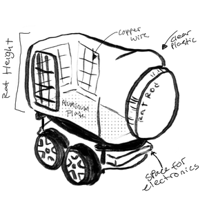

Step 7: Prepare Plastic Container
Now you will use a hot knife or whatever tool you prefer for cutting plastic to cut out three windows in your plastic container. The container will be the driver's seat and the car will steer in a direction corresponding to the window the rat touches (left, center, or right). Around the windows, you will cut holes or slits big enough for you to thread your wire through. I made two holes on each side of my window.
Next, take your copper wire (if it's too thick, the electronics get kind of haunted but if it's too thin your rat will be able to bend it or chew it too easily) and thread it through the holes you've cut to make a grid. Mine was not cute, but it's alright as long as it's not dangerous to the rodent driving.
Step 8: Connecting the Touch Sensor
To connect the touch sensor to the windows you're going to want to solder the corresponding wire to the correct window. By this, I mean make sure your right window turns the car right, and your left turns it left, etc. To attach the jumper wires simply strip the end and solder the exposed wire to any point of the copper wire covering the window. Do this for all three windows.
Step 9: The Platform
You're going to need some sort of raised platform so that the container can sit above all of the electronics. I used a sheet of acrylic with a hole cut out for the battery switch but I think any sturdy foam core or similar material would do the trick. My container is attached to the platform with extra strong double-sided tape.
To raise the platform I used long bolts attached to the base with nuts. This is not the most sturdy option but it works, especially since you need to be able to remove the top platform to mess with the electronics sometimes.
