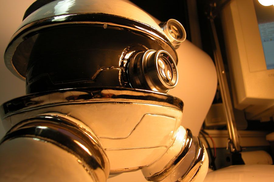

Using the provided ball, socket and pelvis parts in TinkerCAD, I constructed this electronic backpack piece. Special attention was made to ensure that 3mm LED's would fit through the ball joints. I made cutouts to fit a 10 mm LED at the chest, and a slide switch on the bottom. I also designed a print-in-place battery door for ease of assembly, and pulled a stock head and thruster part from TinkerPlay and used TinkerCAD cut out holes to expose more light.
You can grab the parts below.
TIP: When making cutouts for fitting electronic components, allow at least 0.3 mm extra clearance to compensate for tolerances on your 3d printer.
The rest of the parts were simply pulled from TinkerPlay and printed at 100%.
IMPORTANT NOTE: TinkerPlay exports at 75% by default. Ensure that your parts print at 100%, or it will not fit the custom torso.
For my particular piece, I printed with Silver PLA on an Ultimaker 2 at 0.1 mm layer height. The green pieces were printed on a MakerBot Replicator 2 at 0.2 mm using Glow in the dark PLA.
