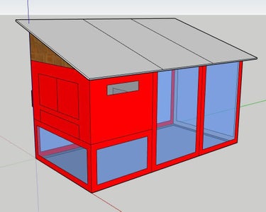

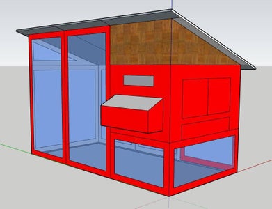

I ended up modeling up something based off of the Carolina Coop in SketchUp with an elevated coop above a fully enclosed run, a large door to access the run, a nest box, two doors to access the coop, a section of the wall that hinges down to clean out the coop, two windows for cross ventilation and a single sloped roof to match the look of the shed. The run measured 6'x12' and the coop itself was 6'x4'.

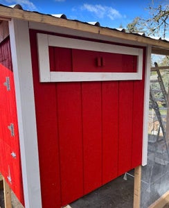

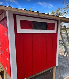

I then cut out and painted siding panels out T1-11 plywood and tacked them onto the 2x3 framing with a siding nailer. I cut holes for the nest box, access to the run, windows, two access doors and a manure clean out door. I then added hinges, handles and latches to hold these mostly closed. After adding some 1x3 trim to hide all of the seams I then started adding some fancy cedar shingling I had leftover from siding my old house and was ready to start working of the roof!

The nesting box was roughly 3'x1'x1' with two dividers inside of it and secured onto the framing with some metal brackets. The windows are 1/4" pieces of plywood with some handles screwed onto them that ride in rabbets on the pieces of 1x3 trim to be able to open and close depending on how much ventilation you want in the coop. I then built a ladder that goes from the fancy automatic coop door that opens and closes based on how light out it is down to the run. For nesting bars I went with I think 1" dowels glued into 2x3's that sit on hinges and allow you to pivot them up out of the way if you need to clean out the coop. Finally I added a chicken swing so that they can roost down in the run but they still haven't figured out what it is actually for yet. Next I went about sealing off the actual coop and run!
