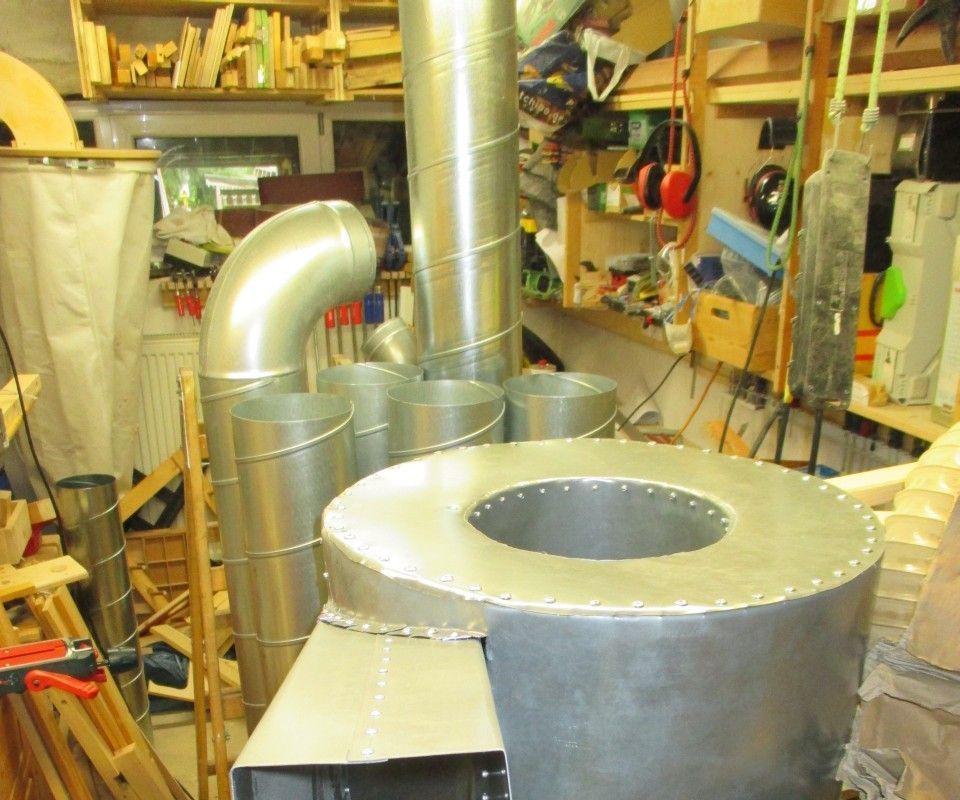

As all woodworkers have problems with miter saw dust extraction I thought of something useful to have the dust collected without spreading it 2 squaremeters around the miter saw. So I got thinking and planning and came to the conclusion how it could work. Since I recently finished my dust extraction cyclone with fine dust cartridges (finally, yeah!) this was the next logical step.
