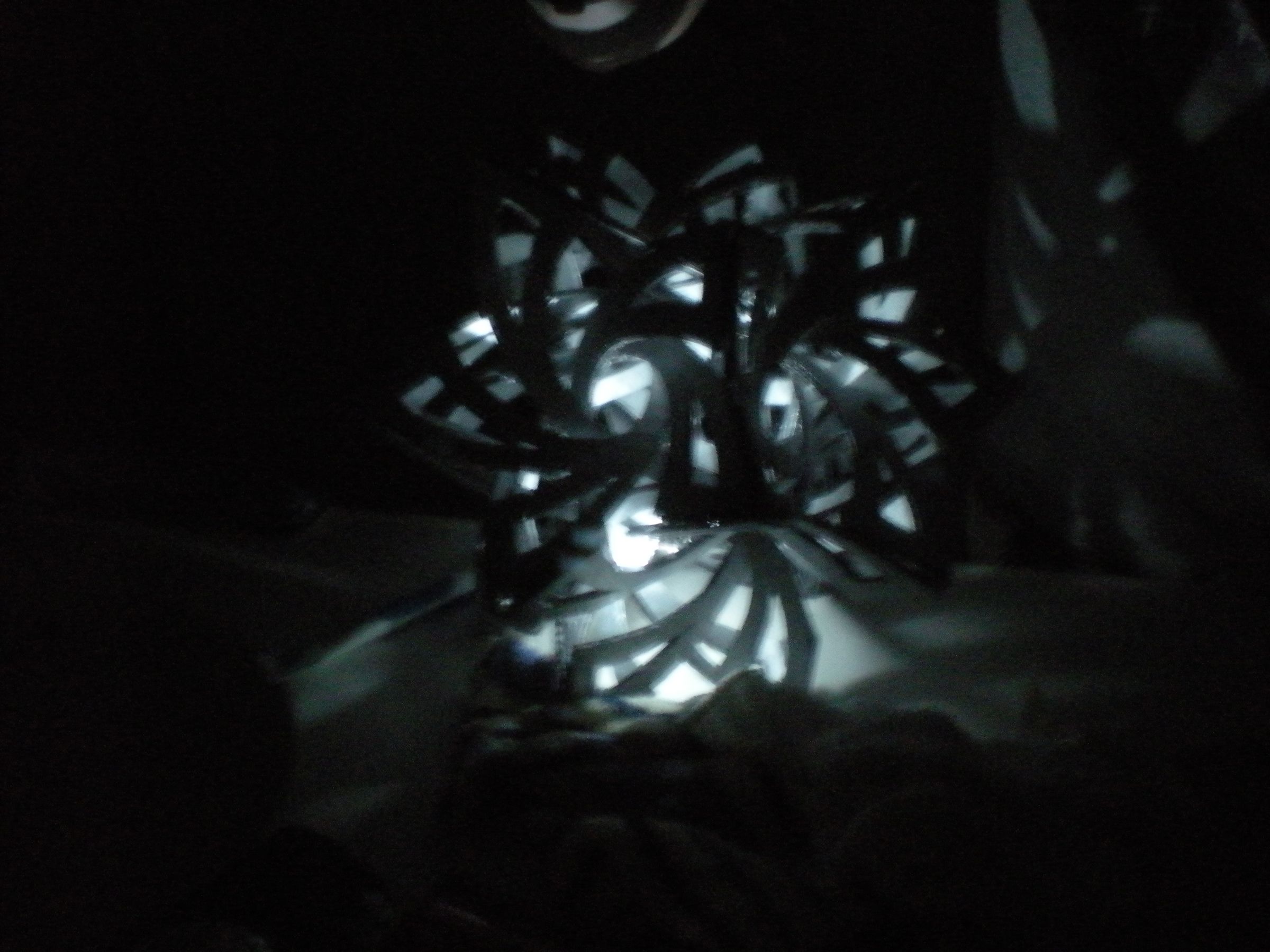

Once the three pyramids were put together, we started using the Post-It Notes to keep track of the points. We even used different colors to identify the four layers.
On each side of the dodecahedron we start with points 1,3, and 4 because it helped stabilize the frabjous and made the construct pattern the same everywhere. When you add in points 2 and 5, the top blossom should be finished (Pic 2).
Picture 3 shows the underneath of the first blossom, which has now become the Upper Layer. Re-number and insert the next five piece to create the second blossom. Make sure the spiral pattern is correct on all the blossoms. Each piece should go over 2 pieces, and under the other 2 pieces.
Once that is finished, flip over to another unfinished blossom, re-number, and finish the blossom. The hardest part here is figuring out if a piece should go under or over one already established. Keep the blossom spiral in mind and you should be able to figure it out. We had to undo and reconnect at least 10 shapes because they were out of place. Don't be afraid to be forceful with the cardboard, it can handle it. An accidental fold is barely noticeable when it is finished.

Edit: Added some pictures with a light in the center due to popular demand. Unfortunately my low quality camera does a poor job capturing the true look, but I hope it gives everyone a good idea of what it looks like.
