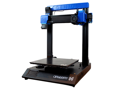

Step 4: Install OctoPrint (for 3D Printing)
1. Create a dedicated user for OctoPrint:
sudo useradd -m octoprint
sudo usermod -a -G tty,dialout octoprint
2 . Install Python dependencies:
sudo apt install -y python3-pip python3-venv git
3 . Switch to the OctoPrint user and set up a virtual environment:
sudo su - octoprint
python3 -m venv OctoPrint
source OctoPrint/bin/activate
pip install octoprint
exit
Step 5: Configure OctoPrint As a Service
1. Create a systemd service fi le:
sudo nano /etc/systemd/system/octoprint.service
Add the following content:
[Unit]
Description=OctoPrint Service
After=network-online.target
[Service]
User=octoprint
ExecStart=/home/octoprint/OctoPrint/bin/octoprint serve
Restart=always
[Install]
WantedBy=multi-user.target
2 . Enable and start the service:
sudo systemctl enable octoprint
sudo systemctl start octoprint

In this final step, we complete the installation of the 3D printing management system using the Raspberry Pi. After configuring network settings, installing control software such as OctoPrint, and connecting the 3D printer, we test the system's functionality. The video presents a live demonstration: sending an STL file, remotely starting the print job, and monitoring the printing parameters in real time via the web interface.
This module wraps up our project by showing how to automate, monitor, and efficiently manage a 3D printer remotely using a Raspberry Pi.
