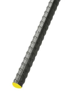

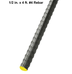

  • 12 pieces of .5" Rebar (48" in length)

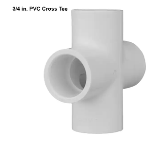

  • 6 pieces of 3/4" PVC Tee
  • 12 pieces of 3/4" PVC Cross Tee

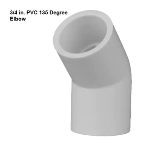

  • 12 pieces of 135 Degree 3/4" PVC Elbow

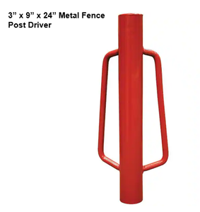

  • 3" x 9" x 24" Metal Fence Post Driver (or Post Pounder)

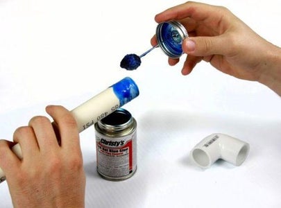

  • PVC Glue and Primer

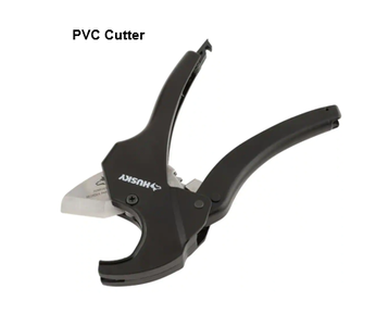

  • Ratcheting PVC Cutter

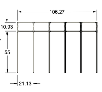

  • To begin, measure and mark the 12 points on the ground to hammer in the rebars. For reference, the width between the rebars on one side is around 21", and the distance between the two sides is about 76.5".
  • Once marked, use a post pounder or hammer to drive around 1/4 to 1/3 of the rebar into the ground. The rebars form the foundation for the rest of the structure, so should be kept as straight as possible using a level tool (I-Beam Level, etc).

  • After the rebars are all hammered into the ground, slip the 3/4" PVC base pipes onto each of the 12 rebars.
  • Glue on the Tee Connectors (5) on the two outermost Base pipes and Cross Tee Connectors (6) on the four Base pipes (1) in between. Make sure the connectors are facing the correct direction.
  • Starting with the outermost Tee Connector, glue in one end of the Horizontal pipe (2), then glue the other end to the Cross Tee Connector.
Also: The glue used for PVCs dry up very fast, which makes it more difficult to estimate the exact length required for the Horizontal pipes (2) connecting the Base pipes. Be careful of cutting the Horizontal pipes too long since the pipe fitting does not slide all the way in.
  • Glue in the Second from Base Pipe (4) for each connector.
  • Lastly, glue in the 135° elbow (7) facing the correct direction.
