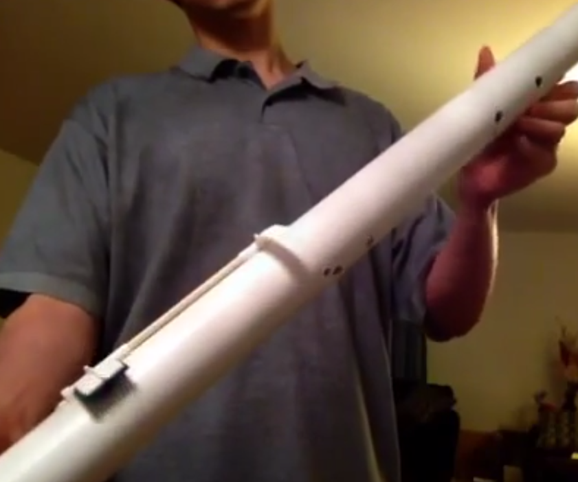

Introduction: A Homemade DIY Great Bass (ie Viola-Range) Recorder for $30-40
In the recorder family, the great bass recorder has a range starting at the C below middle C (that is, the viola range). Instruments in this range provide much-needed bass support for wind ensembles.
Because the recorder's size necessitates keywork, which must be made precisely, commercial great bass recorders sell for $1000 - $2000. Now you can create your own for about $30-40.
Note: the prototype in this video reflects an earlier revision of hole placement. The revision in this Instructable features better tuning.

Step 1: Prepare the Body Tube
Cut pipe to 48.0". (Note: the previous version specified a length of 48.25".)
If you do not cut the pipe squarely (perpendicularly), the fipple piece may not fit, or there will be some uncertainty as to the proper location to drill the toneholes. Obviously, as one of your two cuts you can use the pre-cut side of the 10' length.
Use the file to remove burrs.
Use the better-cut side for the bottom of the instrument (bell).
Before you proceed, it might be a good idea to wash the pipe a little.
Mount the endcap fipple with masking tape.
Excessive air leakage may cause distortion of tuning. As long as the cut was fairly straight, one strip of tape on each side should hold it down well enough.
Don't glue the fipple down yet. You will need to remove it during tonehole drilling and mount it again at the end.
The best orientation is rotated 90 degrees right of centerline. In my opinion, that makes for the most comfortable playing position, which is illustrated in the video.
If you want, you can swab the pipe end with alcohol. You don't know where that thing's been.
Blow to play your first note (the bell note or base note)!
Confirm that the pipe plays within about 10-20 cents of 130.81 Hz (C below middle C).
Any frequency within this range is pretty much acceptable, since frequencies will vary as much as 30-40 cents with your blowing pressure.

Step 2: Mark and Drill Toneholes
Identify the line you want to be the front (centerline).
Often the PVC pipe will have a line of printing. You probably want this side to face you.
Orient the diametrically opposite side to be the front.
Measuring from the bottom of the pipe, mark and drill the following 3/8" toneholes:
258mm: 90° right of centerline
385mm: 40° left
454mm: 10° left
529mm: 40° left
637mm: 40° right
708mm: 10° right
790mm: 40° right
(Previously published measurements for 48.25" tube follow:
260mm: 90° right of centerline
390mm: 40° left
455mm: 10° left
540mm: 40° left
645mm: 40° right
715mm: 10° right
795mm: 40° right)
(Tonehole positions are determined by a combination of complicated mathematical algorithms... plus some good old-fashioned error compensation by estimation. More information is available from the author.)
Using the round file, clear the burrs from within the holes.
Also file lightly over the tops to eliminate burrs that would keep the keys from seating properly. But don't file too aggressively -- you don't want to distort the round profile the key is designed to seat against.
From here on out, it's all about the keys.
It is crucial that the keys seal their holes perfectly, or else the instrument will play poorly.

Step 6: Mount Key Assemblies
Mount keys 1 and 5.
It's easier to install these keys first before the other keys keep you from laying the tube flat.
Use the diagram as a reference.
To fix the hinge pins in place, use the supplied hinge pin guide pieces (A, B, C, D).
Fix in place with hot glue.
Mount key assemblies 2, 3, and 4.
Hold the key assembly snugly in its final place on the main tube.
Apply tacky glue to the hinge wings and slip the wings into position. The wings should be a perfect height to accept the hinge pins.
Install rubber bands and key travel limits.
I have specifically chosen rubber bands over springs because they are more cheaper and plentiful than springs.
Moreover, their movement is easier to control; elastics pull back reliably along their axis, whereas compressed springs often push back off-axis.
Step 7: Your Great Bass Recorder Is Complete!
Reattach the fipple cap.
I recommend it face 90 degrees right of centerline.
