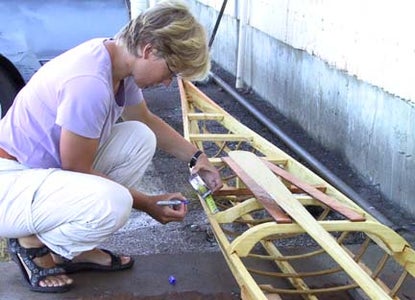

Step 3: Drill Lashing Holes in the Keelson
Drill a 3/16 inch lashing hole in the keelson wherever the keelson intersects a rib.
Step 4: Center the Keelson
Measure the distance from the keelson to the gunwales in a few places to make sure that the keelson is centered. Then go to the end of the boat and sight down the keelson to make sure it is straight.
Step 5: Lash the Keelson to the Ribs
Lash the keelson to the ribs with the nylon mason twine. Cut a piece of twine the length of the boat.
Tie off the line at the bow and start lashing in the direction of the cockpit. You will get somewhere in the vicinity of the cockpit. Clamp off the loose end of lashing twine.
Cut another piece of lashing twine the length of the boat. This time start lashing at the stern. Lash in the direction of the cockpit. Tie the two loose ends of the lashing together where ever they meet.

Step 7: Position the Hull Stringers on the Ribs
The function of the hull stringers is to hold the skin away from the ribs at the sides. The keelson holds the skin off the ribs in the middle.
Hull stringers should run roughly parallel to the bottoms of the gunwales getting about an inch closer at the ends.

Step 10: Drill the Hull Stringers
Drill a 3/16 inch lashing hole in the stringer at every rib to stringer intersection.
Step 11: Lash the Hull Stringers to the Ribs
Lash the hull stringers to the ribs using the same lashing pattern you used for the keelson.
If you have any gaps between the stringers and the ribs that are greater than 1/4 inch, add a shim between the stringer and the rib.
When you're done, double check that the keelson is centered and that the hull stringers are equidistant from the keelson to either side. Although the keelson and stringers are lashed, you can move them around some if you are persistent.
