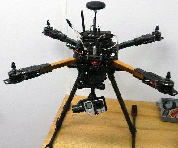

Here is a short video showing the final result, without further tuning. So this is basically what I was aiming for:
So if you are like me and are not scared of failures and sometimes disappointment, then read on, it is going to be a bumpy ride (or flight).... but the result will be rewarding. I will try to provide my own pictures, some downloaded from the net, and also insert links to important websites, where you can learn specific details about different steps. I recommend you start with this one. Next step describes the terminology, parts and tools, where I got them, at what cost and mainly why I chose the parts I used...

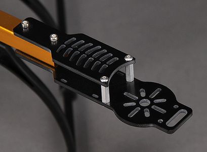

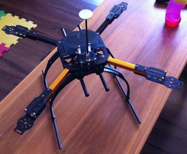

I have chosen this frame because it is the ideal size for my GoPro 4 Black camera, it is light and very rigid, there is almost no twist between the arms, it sits nice and level and there is enough ground clearance for a brushless gimbal between the landing gear.
It is fairly easy to build the HobbyKing X650F frame according the steps in the supplied instructions, I recommend to finish the four arms first, then the central plate where the arms are supported. I also recommend you to use a drop of screw adhesive on every screw, because the props cause a lot of vibration if not balanced well, transferred through the motors directly to the four arms and the central plate. Fixing the screws is important if you don't want you drone to disassemble mid flight....
The arms are color coded, two are black and two are yellow. I installed the yellow arms to the front of the frame, but it is up to you.
I also mounted all four motors on the corresponding motor mounts on the end of each arm. It is very simple, just use correct screws (M3x6 mm), use a drop of screw adhesive on each screw. My motors came without connectors soldered, so I also soldered 3 mm male banana plugs and used heat shrink tube to protect it from shorts. A nice video guide by Graysonhobby showing the basics of soldering can be found here. The ESC comes with presoldered 3 mm female banana plugs on the end of each motor lead.
The last pic shows the frame completely built. The first 9 pictures are not mine, I used Hobbyking website as the source, hopefully they will not sue me... :)
You do not have to install the two top central plates yet, we are going to use the space just above the arms for our ESC in the net step.

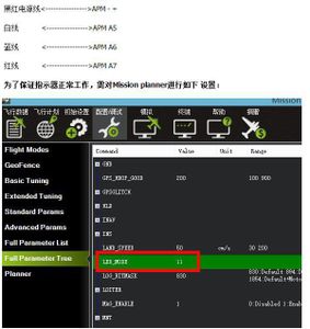

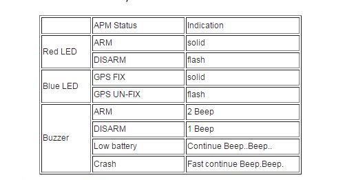

Now for the LED/buzzer module, I secured it on the inside of one of the rear arms, an led the cable through the plates to the APM, the are 2 connectors, connect those as per instructions in the pictures or on the Arducopter website. Buzzer
This is it, nearly all your components are installed, we just add the brushless camera gimbal and after you go through some basic setup steps in Mission Planner, you are ready to go, or fly to be more exact :)
Step 7: Install Your Brushless Camera Gimbal and Battery
It is very easy to install the gimbal, it comes fully built, you just snap on the hooks on to the two 10mm carbon tubes on the underside of your frame, connect one cable to your 12V UBEC output, and one cable to the A11 port on the APM for Pitch control. You need to configure the gimbal in Mission Planner, the instructions are here. I recommend assigning a free channel on your transmitter to a turning knob, for easy pitch control. APM does not provide any stabilization for the gimbal, it is all in the hands of the gimbal controller and its gyros and accelerometers. And I can say it does a pretty good job, the video is butter smooth. APM can however change the pitch of the gimbal when in Auto mode and you have setup a Point of Interest as one of the steps of automatic mission. It will keep the camera pointed at this spot at all times, even rotate the drone so it always points its nose to the target. Very nice feature.
I recommend pushing the gimbal forward on the carbon tubes, so as to get the propellers and landing gear out of Field of View of your camera, it disturbs the image a lot.
Now secure your battery in place on the battery holder with a Velcro strip or a dedicated battery strap. The battery is very heavy, it is in fact heavier than your frame, so it will shift the center of gravity of the entire drone a lot when moving. It is not good, so try to keep it in one place, all the time. You can try to balance you entire drone on one center spot from the underside and move the gimbal and battery front and back until it is nicely balanced. You don't want your first takeoff to be a flip, because of a heavy rear end :)
