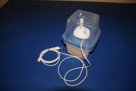

The Halloween seismometer has a magnet suspended at the end of a lever arm that moves
over a coil of wire. The magnet generates a small electrical current in the coil when
it moves. That current is fed into the microphone jack on a computer or digital
recorder. Computer software then analyzes the signal.

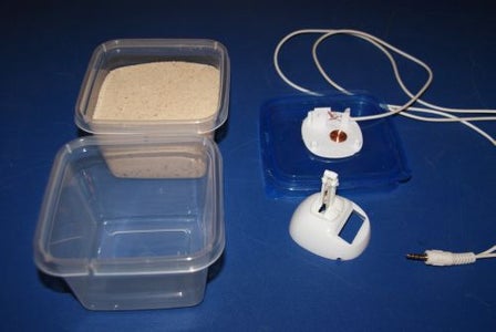

Step 1: Parts and Tools
From Dollar Tree (Pic 1)
Solar Dancing Skeleton or Witch - $1.00
1/8" plug audio cable (See Step 4) - $1.00
4-Pack of 2-Cup Storage Containers - $1.00

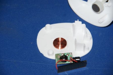

You will see the magnet suspended on the pendulum arm. The solar cell, circuit board
and coil are attached to the base and are exposed as you free the base (Pic 2).
Be very careful not to break the hair-thin wires connecting the coil to the circuit
board.

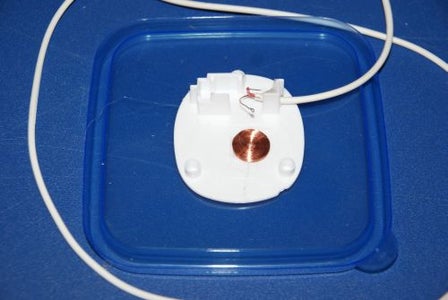

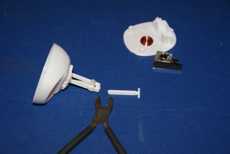

Use the side cutters to clip off the top support for the head (Pic 3). Clip this off
just above the pivot that suspends the magnet arm.

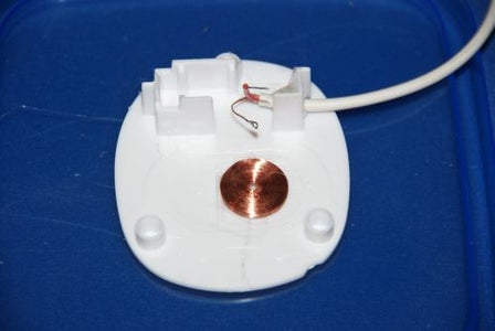

Glue the base plate to the center of the inside of one of the storage container lids
(Pic 1).
Make a small notch in the upper shell of the base over where the cord will exit. You
can use the drill bit to do this or touch the soldering iron tip to the plastic to
melt a small notch (Pic 2).

Glue the storage container cover with the base plate on it back-to-back with a second
cover.
Drill or melt a 1/8" diameter notch in one of the storage containers where the audio
cable will exit. Fill a second container most of the way full of sand (Pic 1).
Press the upper base shell on the base and put the container with the notch on the
container lid with the cord extending out through the notch (Pic 2).
Press the lower lid onto the container of sand (Pic 3). This completes the seismometer
and we are ready to connect it to the computer.
